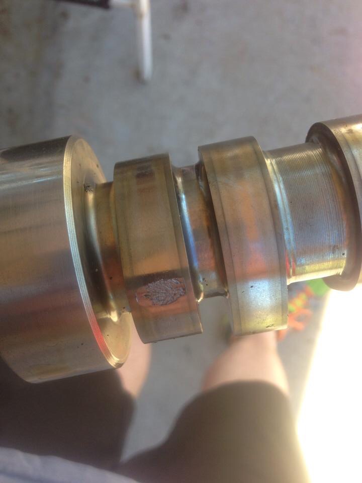

It's not the lifters per say but the factory cam being junk from what I discovered. All of my lifters looked good when my 5.3 started to tick. One cam lobe was missing a chunk of the "case".

^ that happens occasionally on all engines and cant really be tied to AFM lifter issues. Ironically I have a 4.8 non AFM engine sitting in the shop right now with a lobe that looks similar. Was pulling a knock code we couldnt figure out, it was a center lobe, hard to hear audibly, but its wiped. Stoeck OEM cam 03 4.8

Had my DoD turned off for 60K miles, then out of the blue had a lifter fail, took the cam with it. I am much happier with a cam and tune anyways.
