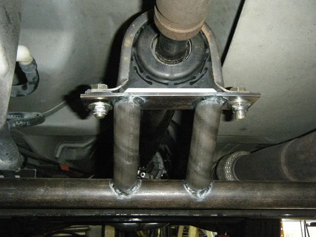

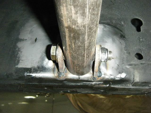

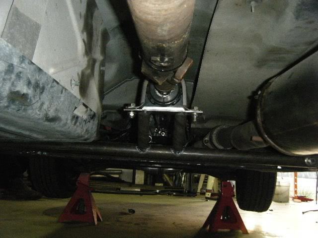

im taking my truck to Madman Tuesday to have him install a real carrier bearing bracket and set my pinion angle.

thanks to MADMAN for this awsome install, and fast turn around! when its time for new stuff i will be back!

looks good, but why not incorporate a drive shaft loop for each shaft side off of that assembly while your there?
just thinking out loud..

thought about it. ill be back after i get some test miles on it and see how everything is. i wanna reweld the shocks to the back, run a different transmission mount for duals later and set the pinion

get up under there and throw a lil pain on there so it wont rust!
