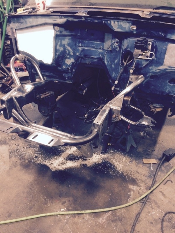

I've lost another 50-60 since this.. This weigh lacked antifreeze and nitrous bottle.. Not your average weight reduction tho..

Originally Posted by George C....
Sawzall
Plasma cutter
Tubing bender
Chromoly
All this goes along ways
And cutoff wheel..
This one dude is supposed to sell me a badass fiberglass bumper..
Holy crap how did you lose 500-600lbs off the front end
