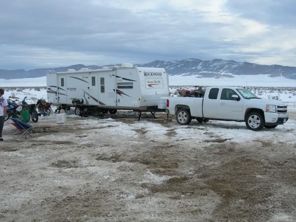

when my truck was stock i had the stock goodyears and i towed quite a bit with them. Truck did great, i have a 32' travel trailer that dry weight is 7500lbs and it towed it great even in ice and snow. Fully loaded it was closer to the 9K mark and still did fine even with the quad in the bed. Although i did use a weight distribution hitch, but it did work amazing.
