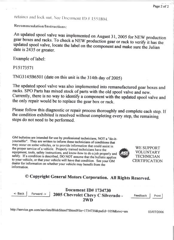

I had this problem and ended up taking it in 3 times for warranty. GM says it fluid moving through the spool valve in the rack and pinion and its is inherent to the vehicle. They told me the second trip and second rack later that i just had to live with it. HAHA so they thought. I went in the third time and told them i wasnt leaving till it was fixed. They ended up replacing the rack for a third time and used EXTREME cold climate fluid. Havent had a problem since.

I found the letter. Check this out!
Spool Valve Page 1
Spool Valve Page 2
also the fluid was changed to EXTREME COLD CLIMATE FLUID part # 12345866 and i havent had a problem since.
