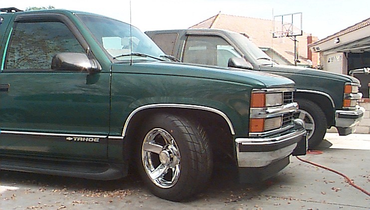

This is what a 275/50 R17 looks like on a 8.5" rim on the front: (these are drag radials that I bolted on up front to see if I like this size for all four)
http://bertok.us/pics/tires-275a.jpg
http://bertok.us/pics/tires-275b.jpg

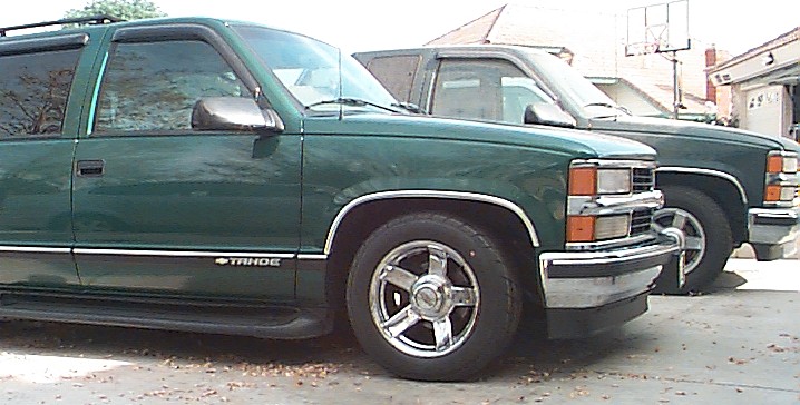

Here's when I was running 275/50/17's all the way around way back when. It's not a great shot but it gives you an idea. If you still want a better picture if your thinking about running 275's let me know and I'll go snap another shot.
