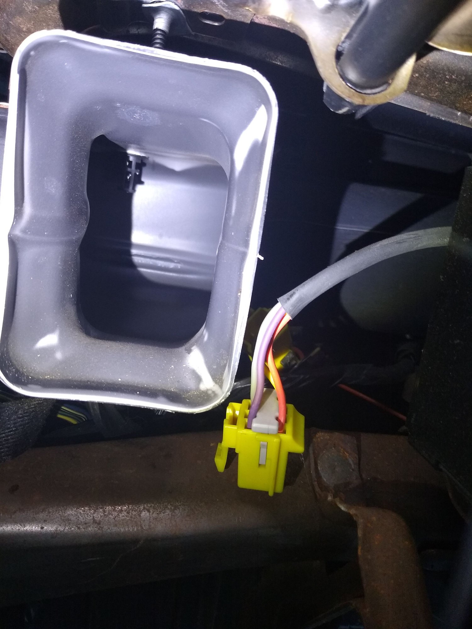

Well, I got to messing around with my Innova 5610 handheld scanner and it turns out it has SRS and some other features I wasn't aware of.
I hooked it up to my Suburban and found a bunch of Bxxx codes on the passenger side airbag. Open, out-of-range and something else. Found a yellow connector under the driver seat unplugged (that was me when I removed my center console,) and a yellow connector near the passenger side airbag module unplugged (probably my mechanic.)
I cleared those codes and no more airbag light! I'm down to the TPMS light. 🤭

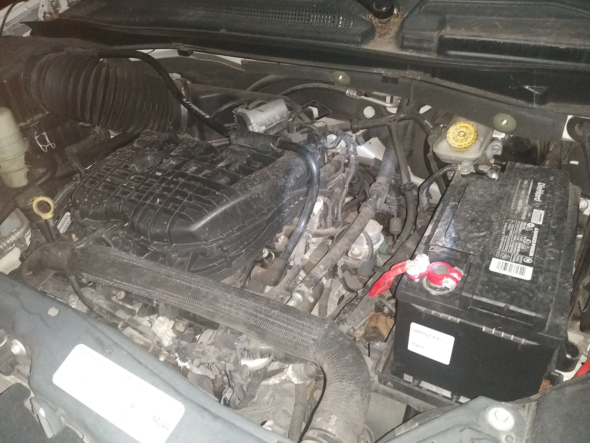

I also messed around with the Mopar minivan, but no progress on that one. I have some TCC and other transmission codes, and the accelerator pedal codes. I was hoping to do a TPS relearn, looks like this scanner has that capability. But I can't connect to some modules, including the transmission module. 🤔
The gas pedal has no response if I depressed it.
So to recap on this vehicle: the ECU was replaced with a remanufactured one (because the alternator wasn't charging, which now seems fixed) programmed per the VIN. All of these codes popped up after that. One of those ratcheting ECU connectors got stripped when I removed it. I put a zip tie thinking maybe it wasn't making good contact, but no dice.
Any Mopar guys around? I'll swap back the old PCM and see what happens 🤞

Well, I'll be damned. I popped in the old ECU on the 3.6 and everything works! Gas pedal, no TCC codes and I'm able to see the modules. I do have a permanent low voltage code, which was obviously the problem to begin with. It's looking like I got an ECU not programmed for this vehicle. Doh!
I'll call the ECU folks and hopefully they can send me the right one.
