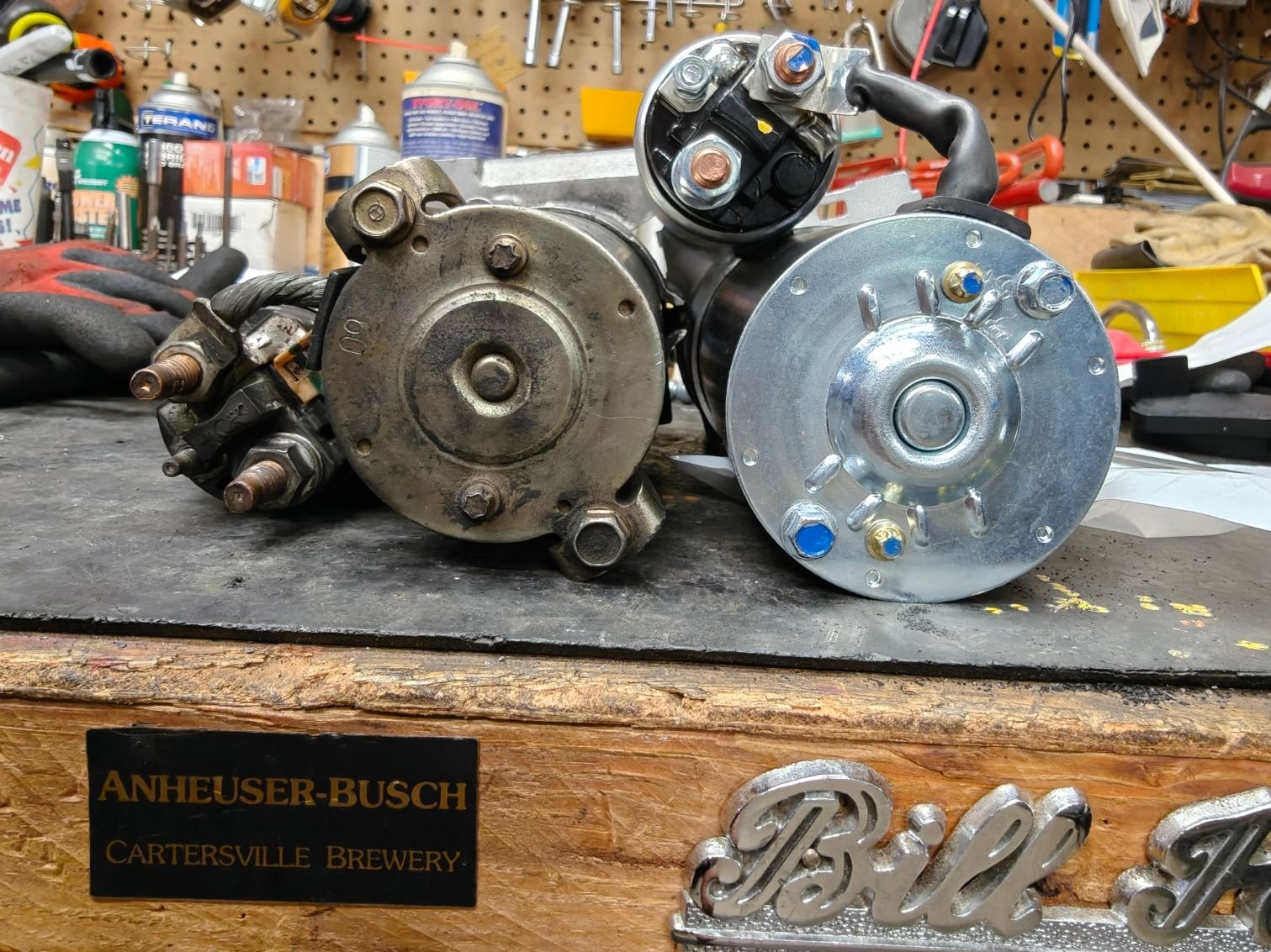

Anyway the new starter is in. I'm sure there are loads of starter replacement threads on the Webb so the only thing I can contribute is having the truck since new in 2004 and searching for the replacement via VIN number the ACDelco Gold box I received contained a larger, heavier, and more powerful unit.
Part weight is 8lbs vs the 6.8bls original.
Motor O.D is 2-7/8" vs. 2-1/2".
Motor Length is 9" vs. 8.25"
Power rating is 1.7KW vs. 1.0KW.
It bolted up fine. The sound and turnover speed is a totally different experience.

The smaller one on the left is a 6489, came stock on the 4.8 and 5.3 liter, they work fine until worn out: Usual fix is a brush set, and a solenoid, and clean up the drive pinion splines, grease the planetary gears and front nose needle bearing, run it another decade.
. The upgrayyd on right is the newer 6494 first used on Escalade, and the 6.0 HD trucks, a slight bit more torque. You might have gotten lucky and bought a decent one, if it's **** you'll replace the solenoid in a few years. TRY and get a good Delco or ZEN solenoid when the time comes. Lot of really shitty components out there.
