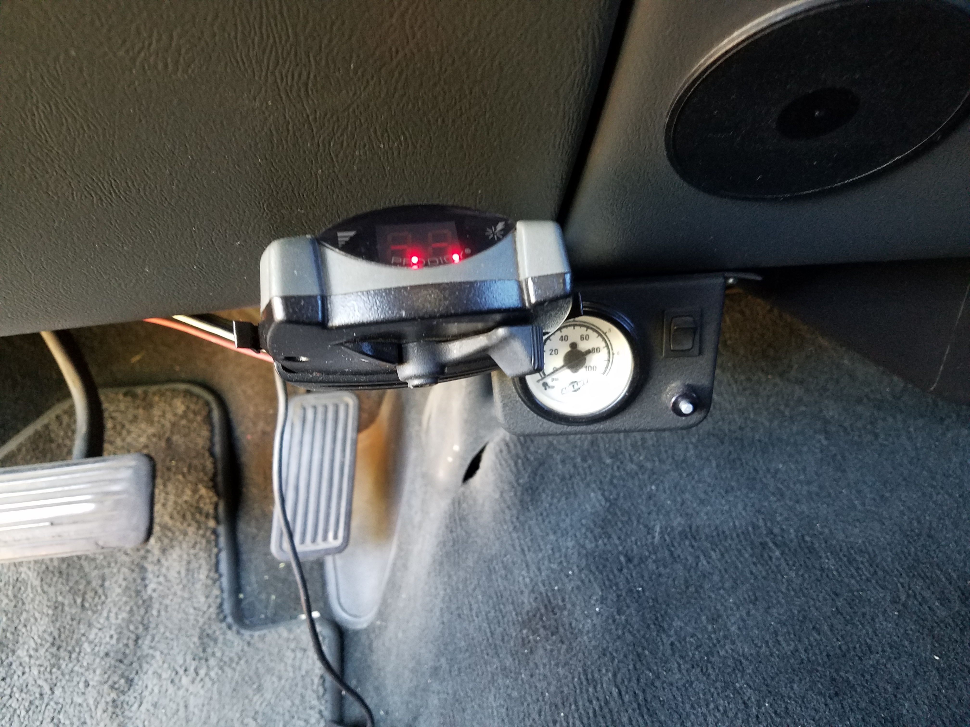

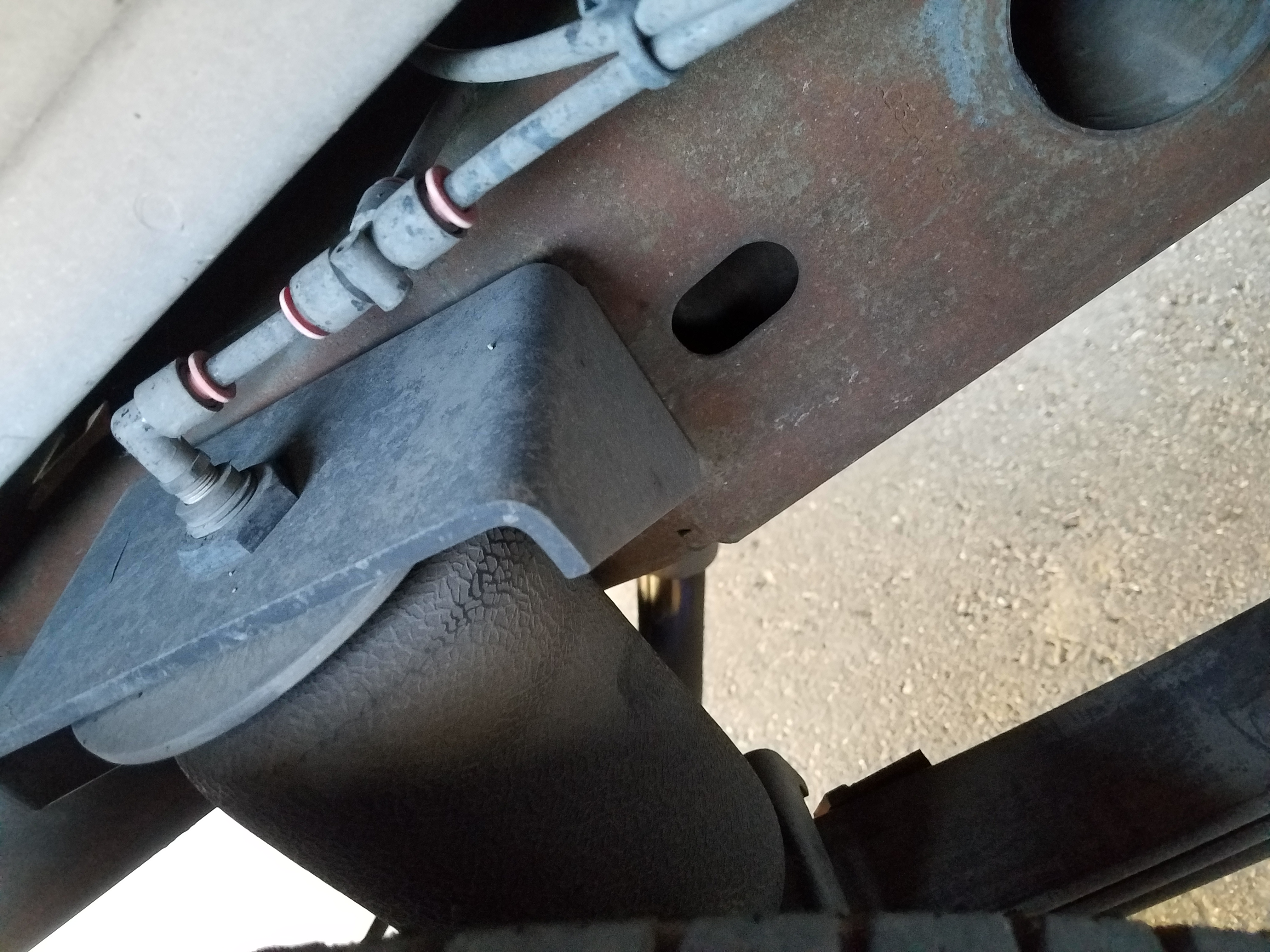

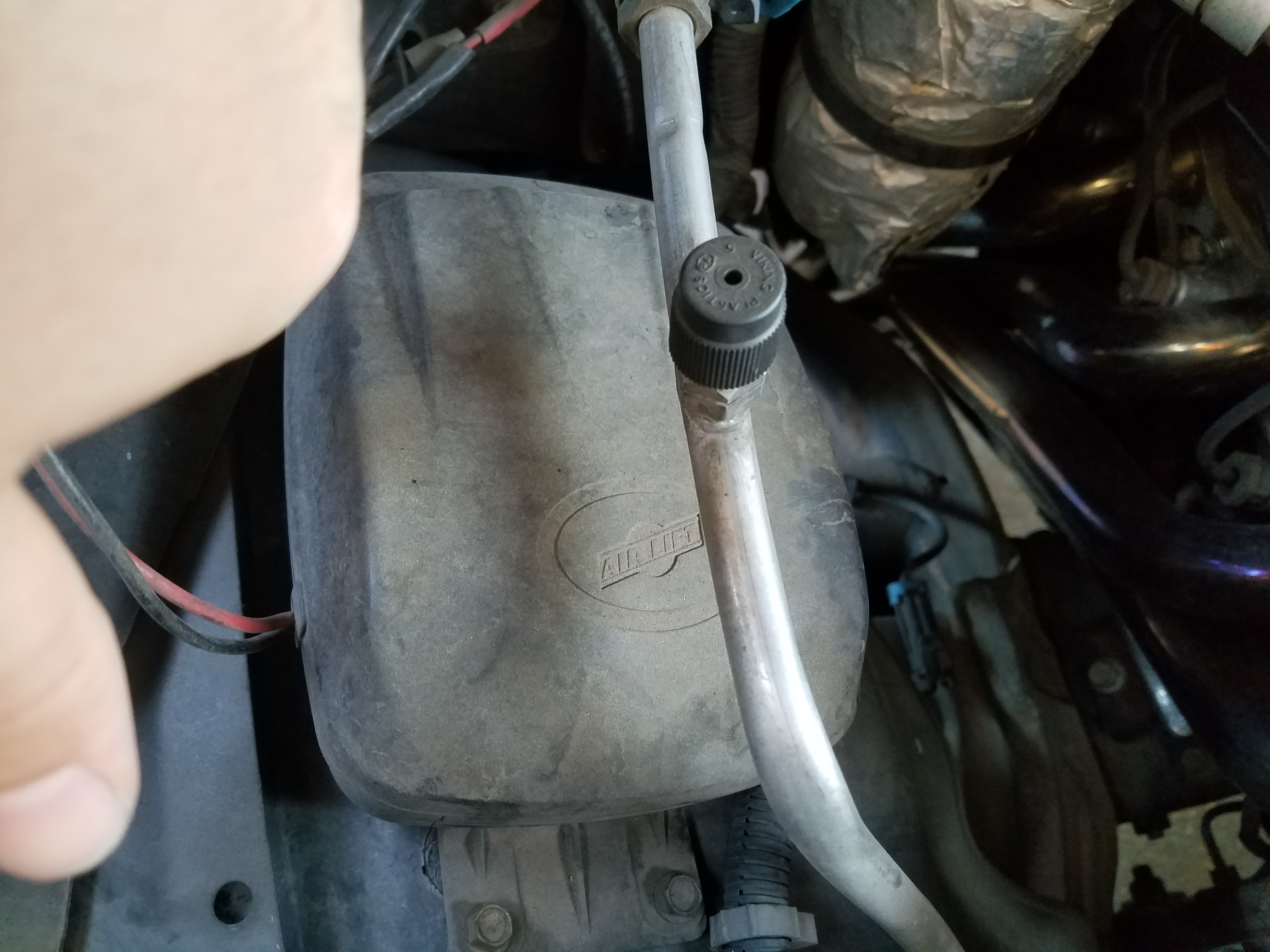

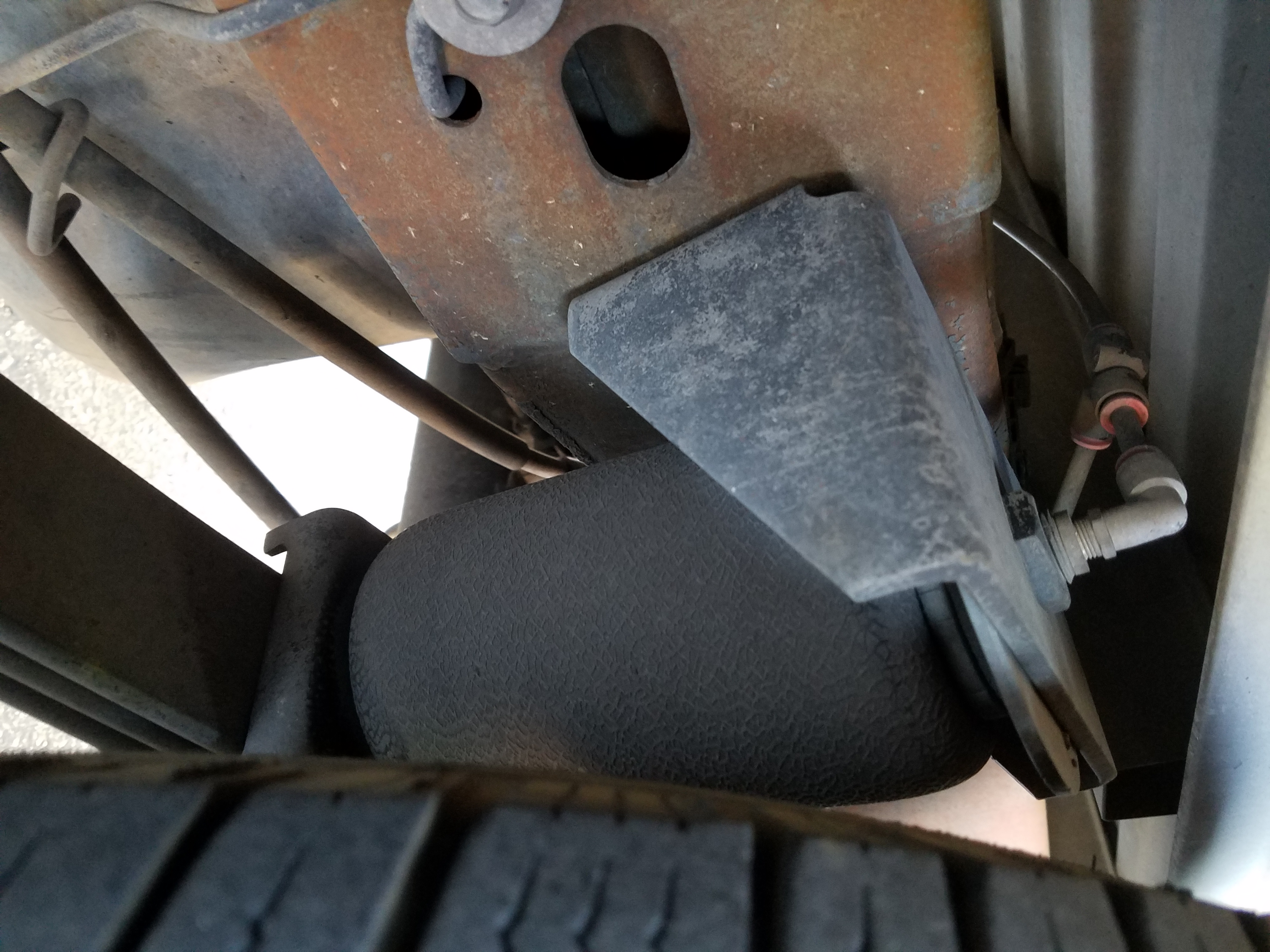

From: BFE Arizona
Sorry dirty and dusty its AZ

And 3 more! Also have a brake control if needed!
