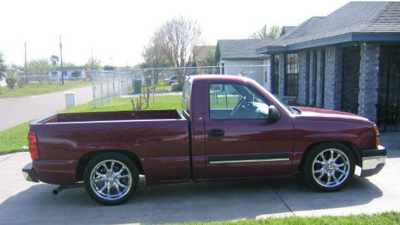

My truck is a chevy 04, 5.3, I have the stock gears which are 3.42's, either looking to buy some 3.73's or 3.90's which ones do you all recomend, i do alot of traveling on the highway, so im leaning towards 3.73's and for the track put a smaller tire, also what brand of gears to you all recommend i dont want something noisy, i've heard good comments about richmond and superior. Thanks in advance

i have the 3.73 but if i would have thought about it more i would have gotten the 3.90 because with the 22" rims it is about the same as haveing 3.73. , but i am really happy with the 3.73 and it is really nice to put smaller tires on there and really wake it up.
