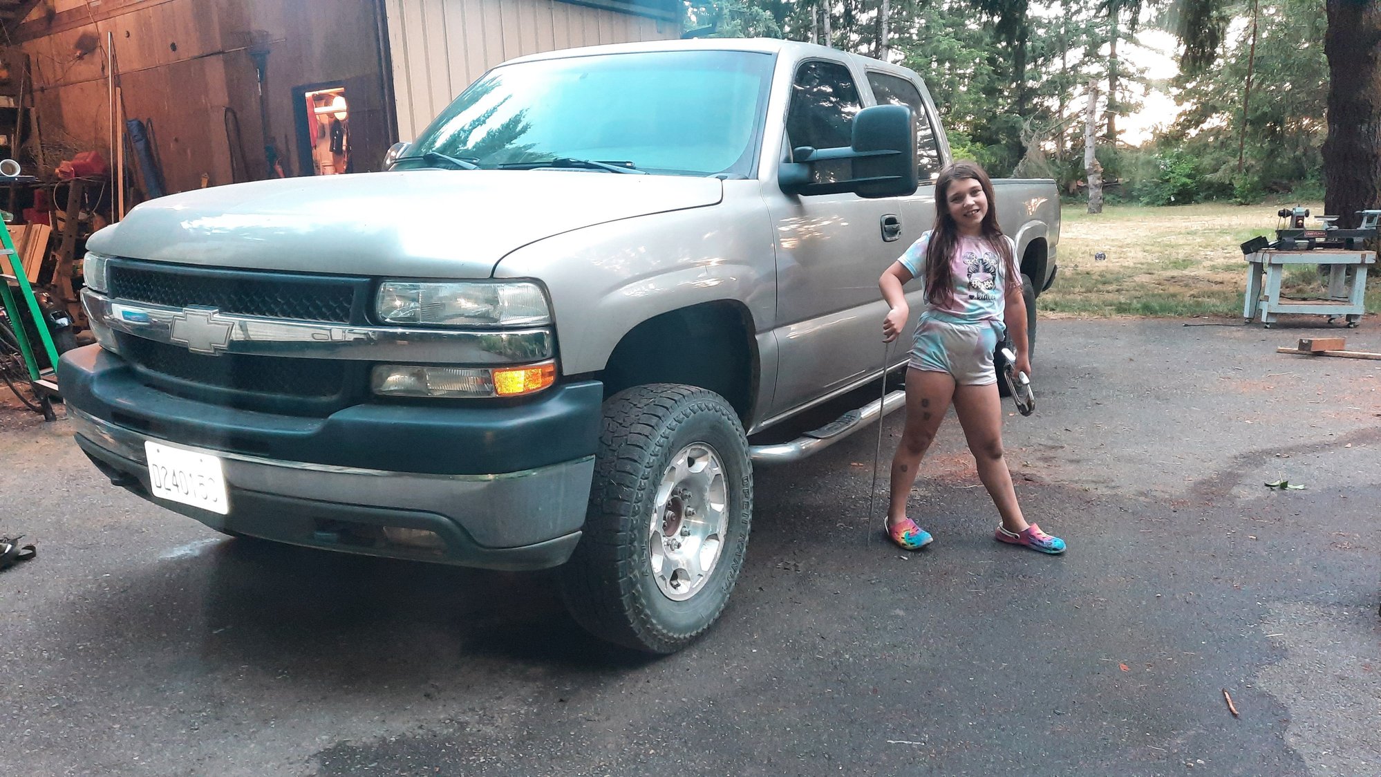

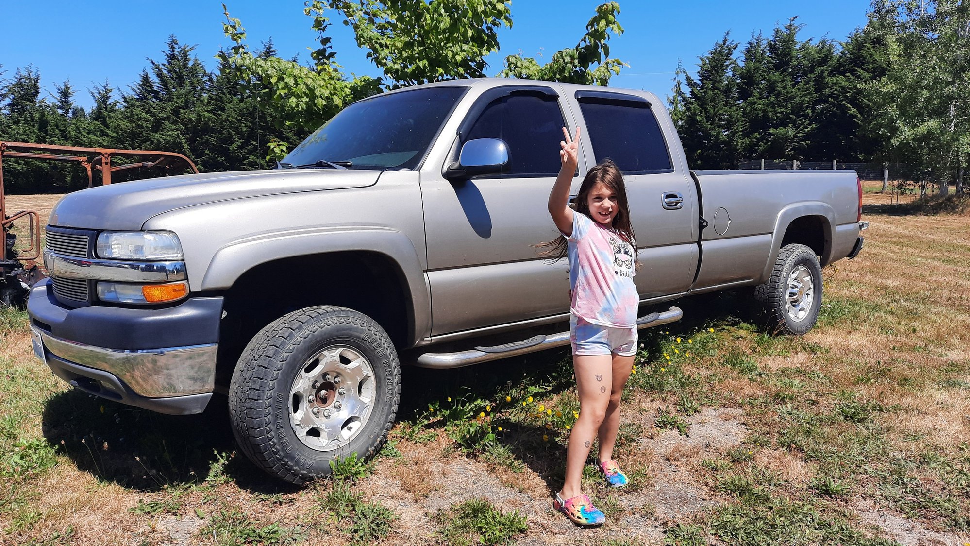

Here's when I picked it up:
And about 30 minutes after I got it home. Need to get rid of all the rest of the fake chrome, fender flares, window vent covers, etc.
Those are fake tattoos, not bruises BTW.
