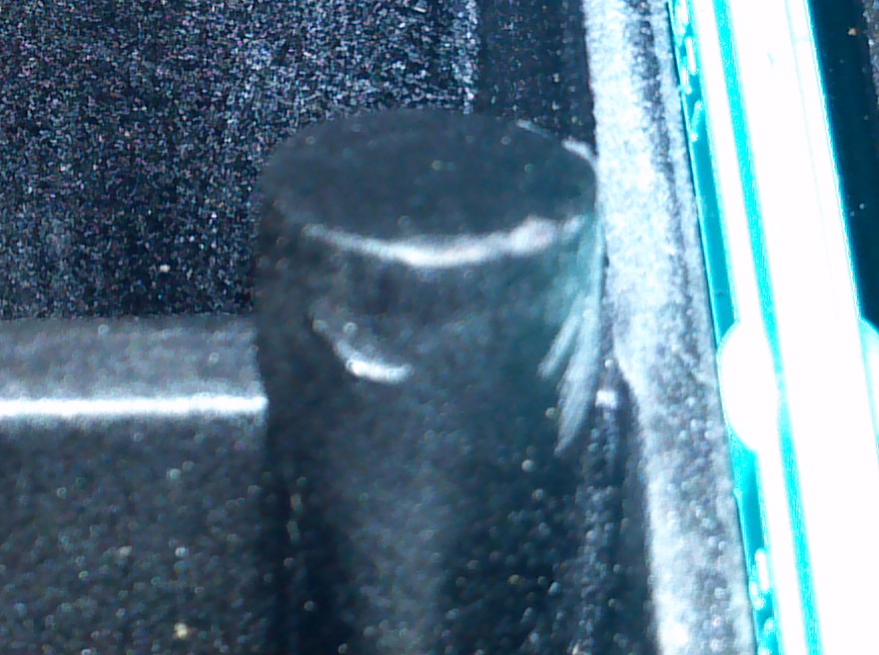

Don't know what to do. I have a set of LSA heads and an LS3 intake off of a 2012 Camaro. There is a little "nub" on both sides of the intake between the 2nd and 3rd port. What should i do?

take a picture of it so we can see

that question leaves out a lot of importance.
if they dont fit the head because of the "nub" then trim it off to make the intake sit flat.

It's a simple fix we see this allot all you have to do is cut the locators off the intake. With the way the intake bolts are they will get you re aligned. i promise all will be good....

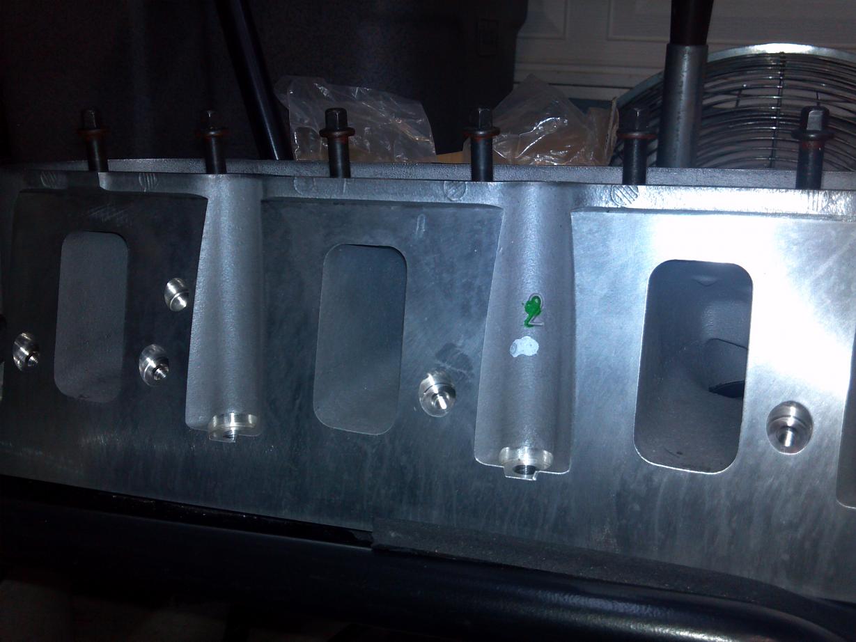

Default Added pictures
These might help.
Please let me know what I should do.
