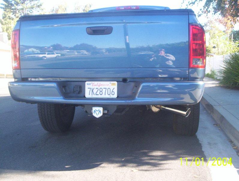

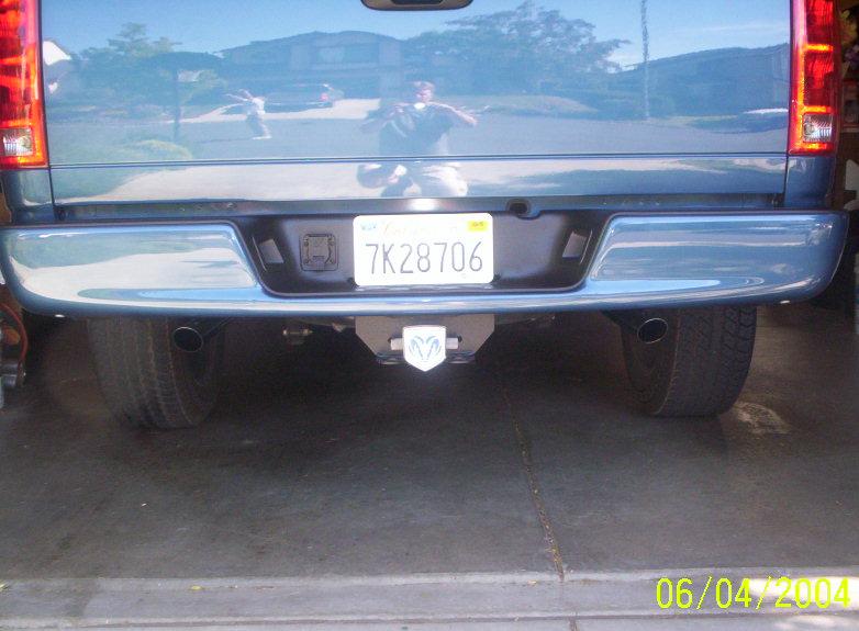

Thought you might get a kick out of it.Did you change mufflers besides pipes?from what to what?

I went from a SI/DO Magnaflow muffler with 2.25" tailpipes with 2.5" tips straight out the back to a single 3" Magnaflow system, using the stock tailpipe with the OEM resonator. It's a little quieter, doesn't resonate and actually added some power. Here's a couple of pics.
