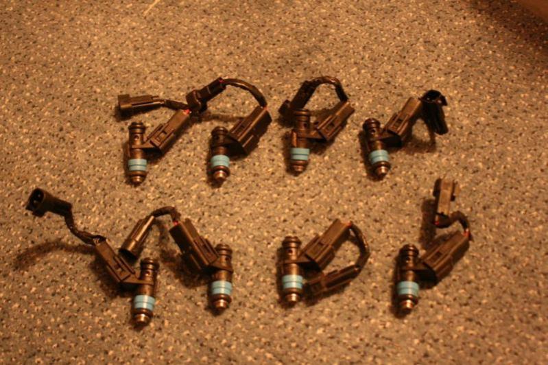

Motron 60# LS7 style injectors w/EV1 adapters, direct connect to ls7 and ls2, will work with ls1 with the adapters
looking to buy these from a member and just want to know if they will bolt right up to my intake? its 2001 truck intake.
Attached Thumbnails help!! will these motrons fit my intake?-newcamera110.jpg

What kinda intake you have???

truck intake.... is there a certain number your asking for? its the stock intake that comes from a 2001

I just checked little while ago 3/8's too short.You could probably modify the mounts on the intake to lower the rails.
