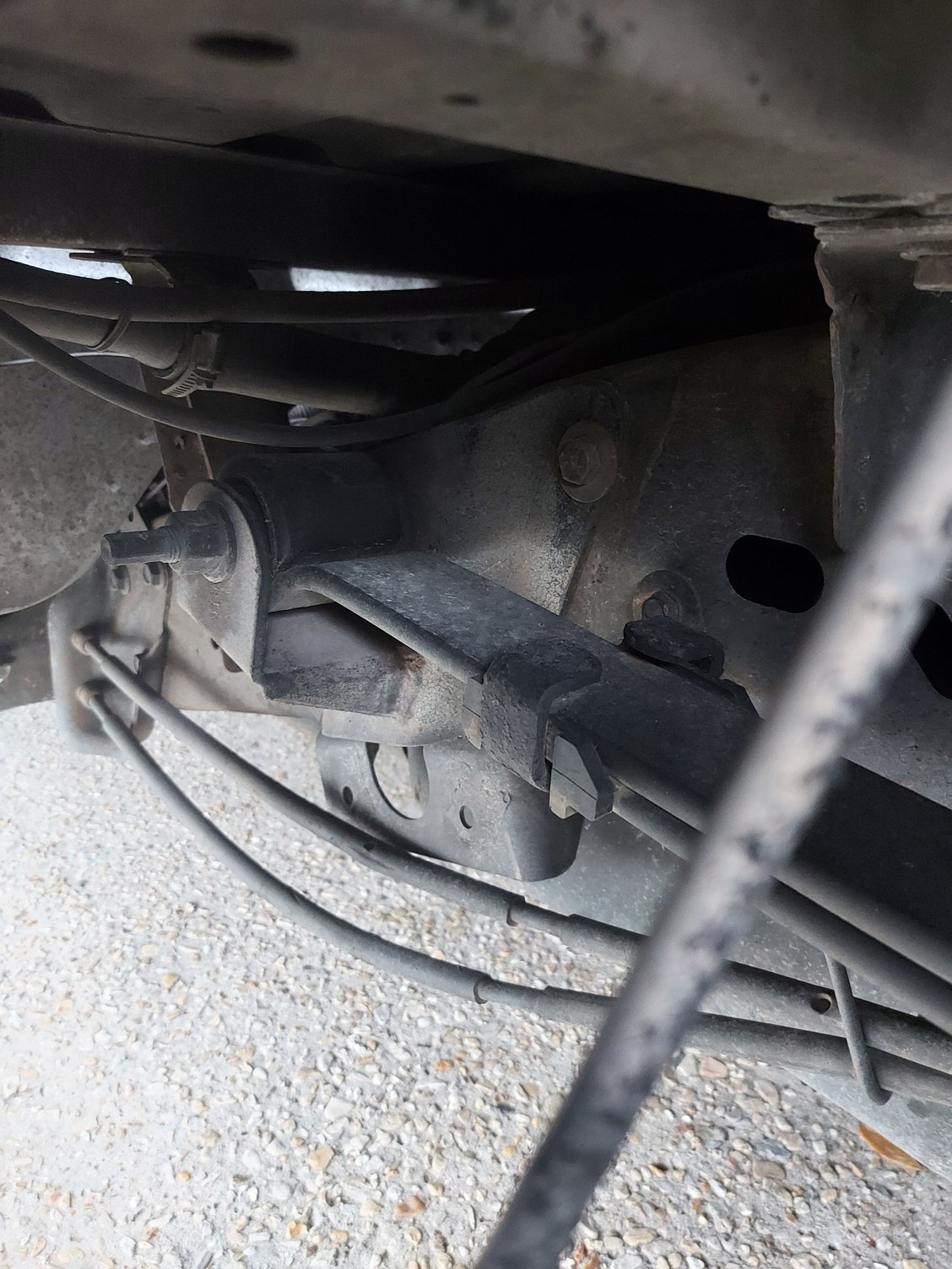

Truck is a 2007 classic single cab short bed. Lowered by a previous owner. I bought some traction bars to install but my hangers seem to be upside down? So i cant use them.
I bought some different 2" drop hangers. The springs mount in from the bottom, like every other set ive seen. Problem im having...the 2" drop hangers RAISE my truck by a good 2".
Below are pics of my hangers that came on the truck, and of a stock set, respectively. What hangers are these?

Look like cut and rewelded stockers to me

You might be right.

They look like belltech lowering hangers or maybe DJM lowering hangers. I had a similar set on my 2006 single cab.
