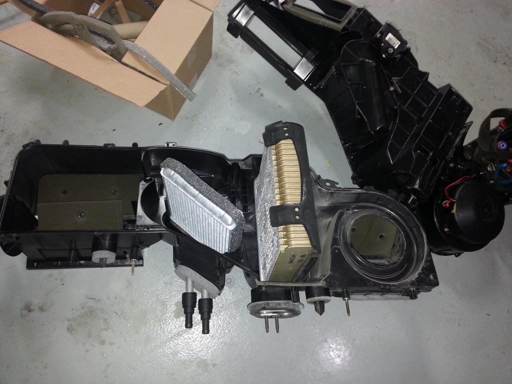

I am in the middle of doing this right now. I too ordered a core from Rock Auto. As of now I have replaced the core, got hvac case back in, coolant filled up and bled. I have tested the heat and all blend doors with my dash still out to make sure everything works before putting it all back together.
While I was at it I replaced the Tstat, some hoses and clamps, my truck is a NBS early 2000 ECSB.
I'm a refrigeration mechanic by trade so I had all the tools to recover the refrigerant. Today I'm going to put it all back together and get the A/C charged back up.
You should probably replace the heater core fittings, mine were brittle and cracked when I removed them from the core.....

Yup its a little bit of work. If i remember correctly you dont have to split the whole case open. Above the heater core where the tubes com out there is a cover that comes off and you can pull the heater core straight out. Of course the case still has to come out just to clarify lol.

Good Tip on the Plastic fittings!!!
There usually fairly brittle from all the heat cycles due to the age of these trucks.
Yeah, in a pinch you could just slide the heater hose over the heater core pipe stubs and clamp them directly not using the fittings at all....
