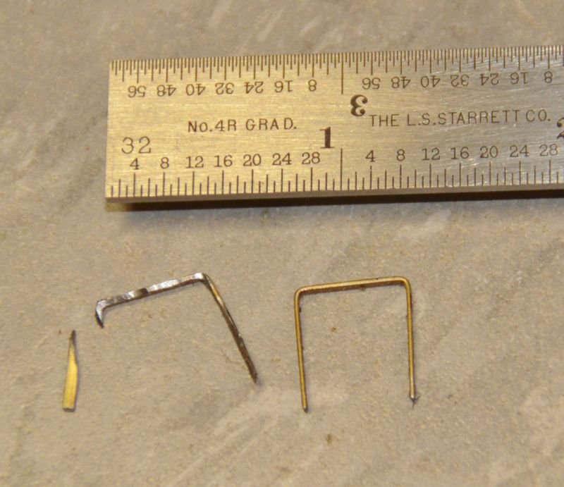

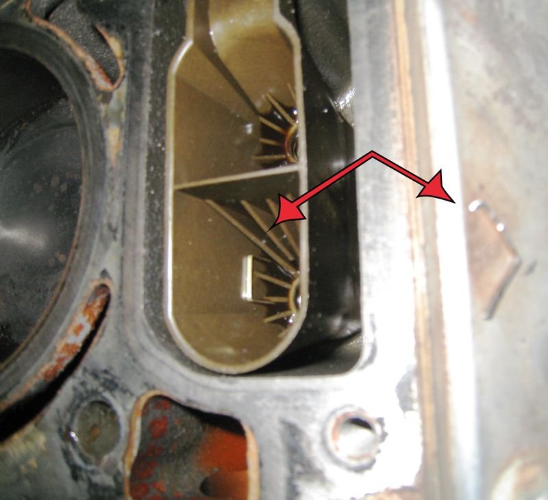

You just never know what you find when you open-- up an engine. I pulled the heads off to do a head swap and I found two 9/16” staples inside. One in two pieces under the passenger side valve cover and one setting on the same side lifter tray. I did have the covers off years ago to change the valves springs for a cam swap. So, the one that got chewed up by the springs could off gone in then----but not the one on the tray.
The inside was clean, 73000 miles of 10-30 Moble1 changed whenever it starts to get dark. But the inside the intake was a dirty caked on oil mess. I tried a rattling type PCV, it came with a plain orifice type, but with both it still uses oil on the highway. So, looks like a LS6 # 12577927 valley cover is in order. The 5.3 has the PCV in the driver’s side valve cover now.

One in the tray, the other with the valve springs.

Those are wood staples. You got punked somehow. Location of the oil catch can will help you, I would mount it in vicinity to the front corner above the power steering pump (near the exhaust manifold)

I think my neighbors to the North punked me, I live in ND and the truck was built in Canada. Nooo body else was in my garage when I pulled the heads off. On the broken staple one can see it was smashed multiple times until it broke.
