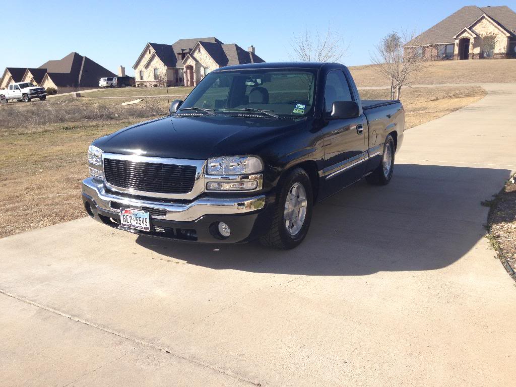

Truck
2004 GMC Sierra 2wd 2/4 drop
Tire Size
275/60/17
Front Drop
DJM 2 in drop lower control arms
Rear Drop
Axle flip, all stock, lowered rear mount 2in.
Pinion angle -3*
Shocks
Bilstein HD
Misc. Parts
c-notch

That truck sick.
