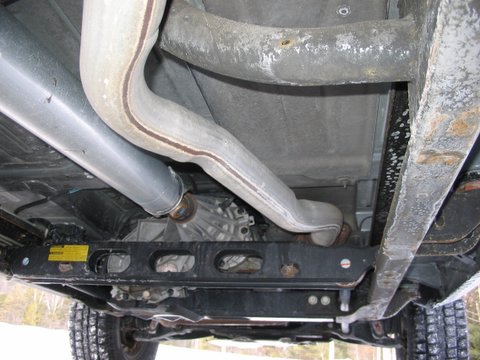

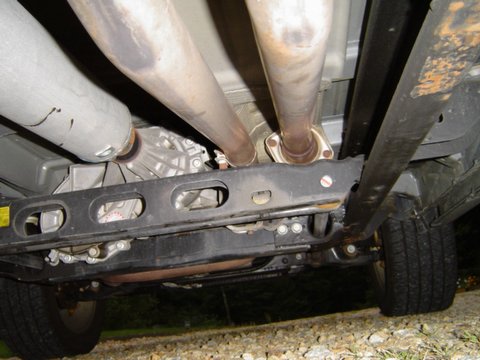

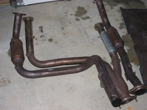

The SS and Sierra Denali/Escalade has a Dual pipe Cat pipe that doesn't y together like the 5.3. From there its dual pipes into the muffler with a signal pipe outlet. The 5.3,6.0 1500 pipes are very similiar with the only differance being the 6.0l' 1500 doesn't y together.The 2500 6.0 pipes are differant than the rest
The Silverado SS catback and y-pipe will fit a Ext Cab 5.3 and I'm in the process of doing it to my GMC. I want to run a catback off a SS so its duals incase I throw a 6.0 in the GMC or Boost.
I attacthed some pics of the Silverado SS pipe ves the 5.3 y-pipe(my 5.3 pipe doesn't have any cats.I also included a pic of the stock GMC exhaust and a pic of a Silverado SS catback taken form about the same view.

Great picturs, that really explains the difference.
