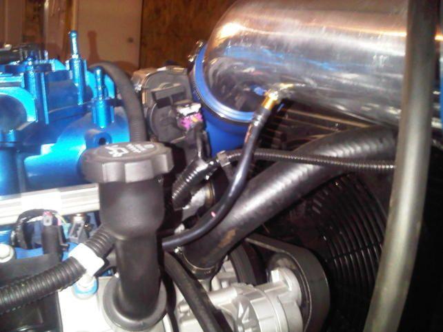

Originally Posted by Unable001
Ok cool. So the one coming off the passenger valve cover, does it matter where on the intake manifold I tap into?
No, doesn’t matter. Just somewhere on the intake tube bw the throttle body and air filter. Here’s an example...
