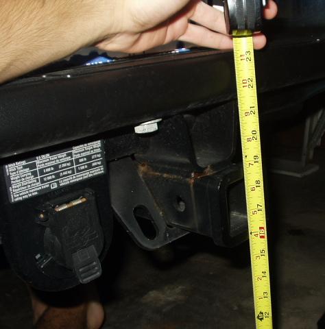

i dotn know which part of the hitch u wanted so i just put the old tape measure up and u can take what u want from it.... hope it helps
Attached Thumbnails A favor from the coil-spring rear vehicles, please...-hitch_height.jpg

Sweet, thanks a lot guys. Perfect picture, niwtsol...
I'm trying to figure out what's happening when I hitch up to the trailer.
I had the hitch on the Av at the +3/4" position...
While the SS needs it in the -2" position - even though I believe the truck is already lower than the Av. (This hitch-to-ground measurement will help me figure that part out.)
The Av definitely had more rake to the front, and much more suspension travel out back. I think I'll be doing airbag helpers to bring the rear of the SS back up a bit.
