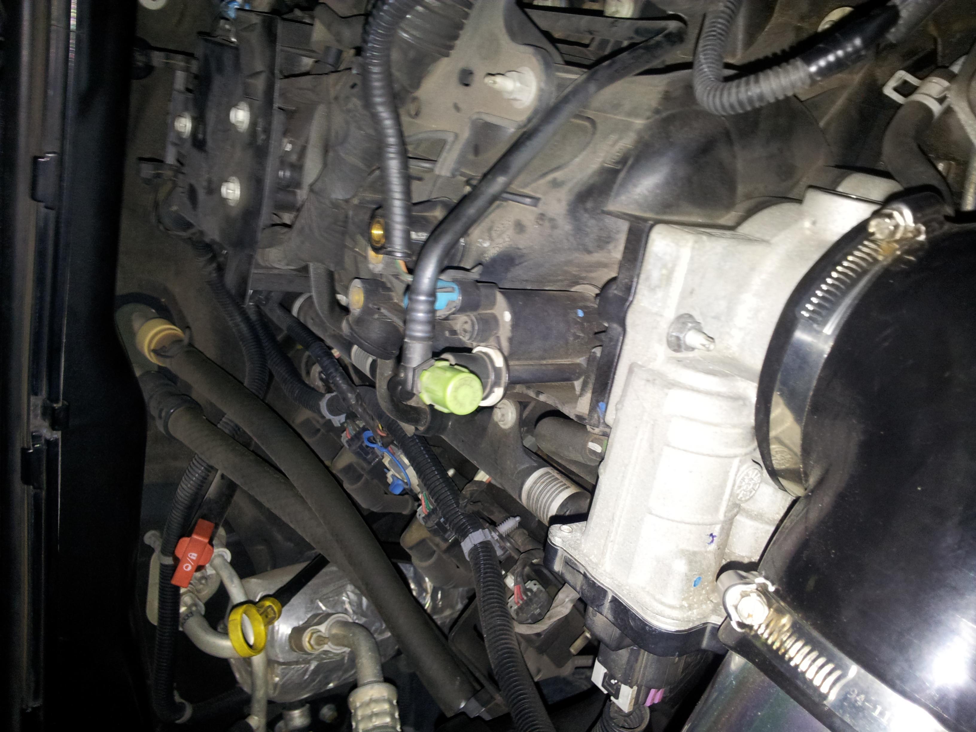

Also I am going to attach a picture of something on the motor if anybody can tell me what this is I would appreciate it, It has the green cap on it.

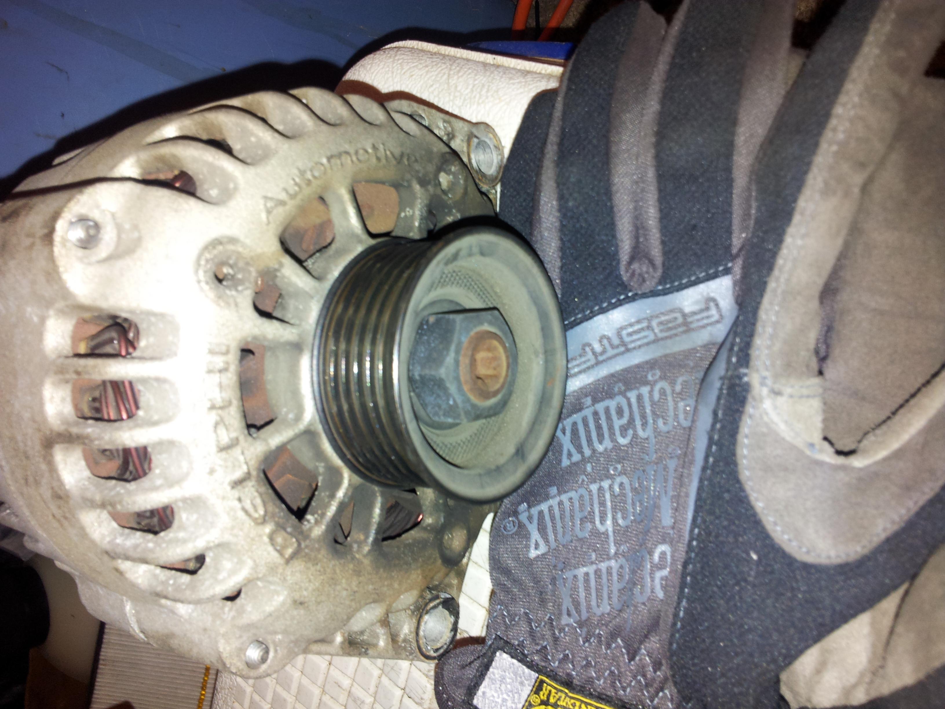

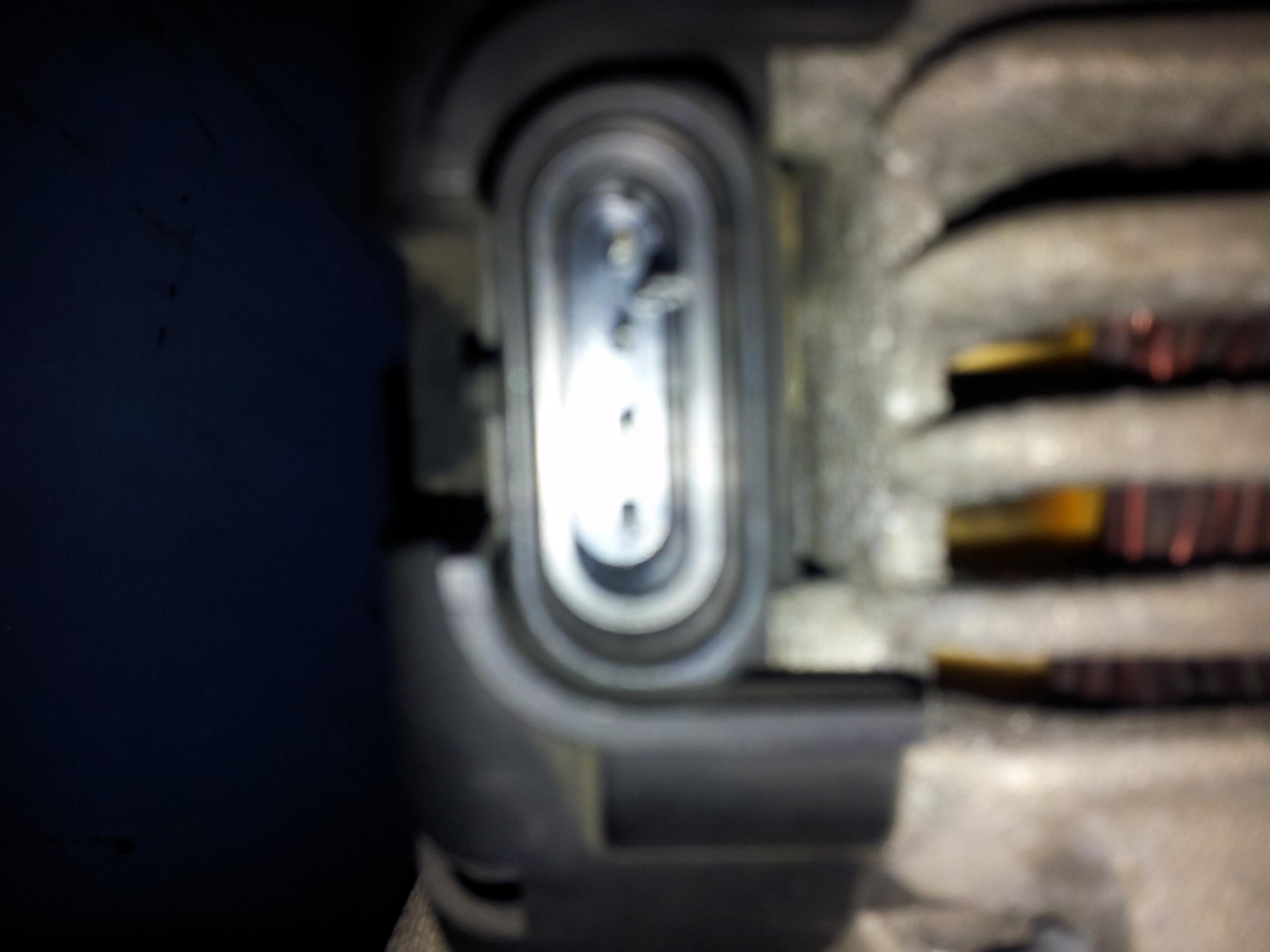

You will most likely have the 105 amp alt unless you have it swapped to the larger 145 amp unit. This can be done but you will need a bit longer belt as the 145 amp case is bigger. I would recommend doing this if you have a lot of extra accessories your trying to power. Look at an 03 Silverado SS for the 145 amp alt.
