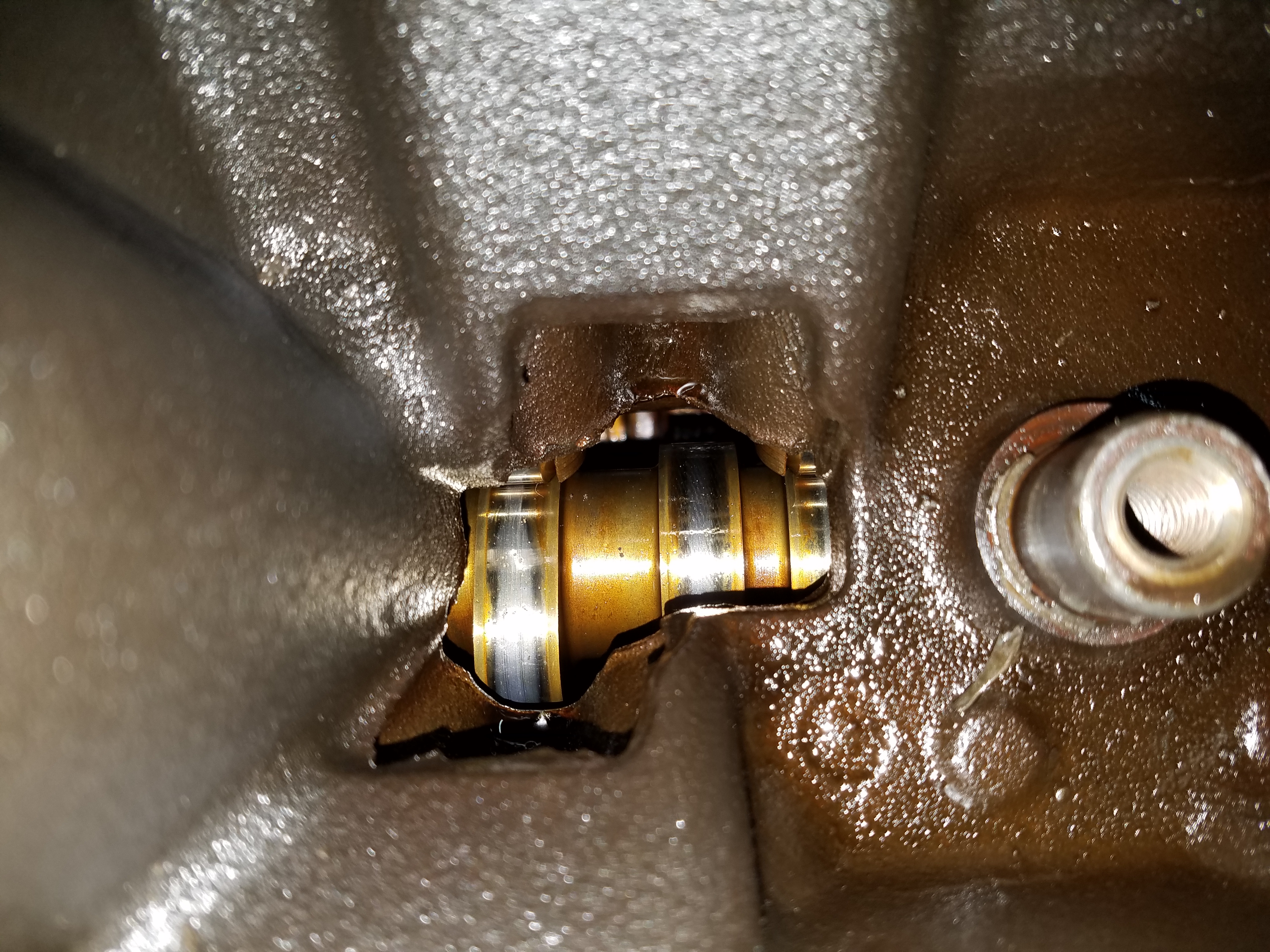

Also i did a valley cover gasket and knock sensors not to long ago and was able to see a piece of my cam lobes. Got a picture. Not bad for 295k huh? Shows why my lifter is making noise. BTW not metal just some dirty.

Heres the pic..^^^^

Cam looks fine from that picture, can't really see the top of the lobe where the factory cam's start to get chewed away.

Think i should just cam it and let it rip tater chip?

That was just an opinion on the cam.
I think your thoughts towards the cam swap is still valid, I'd go for the mods you picked if that's the route you want to take.
Seems like it's a good choice of parts. Though upgrading headers doesn't seem worth it to me. The cam/heads would pick up a decent power for you.
