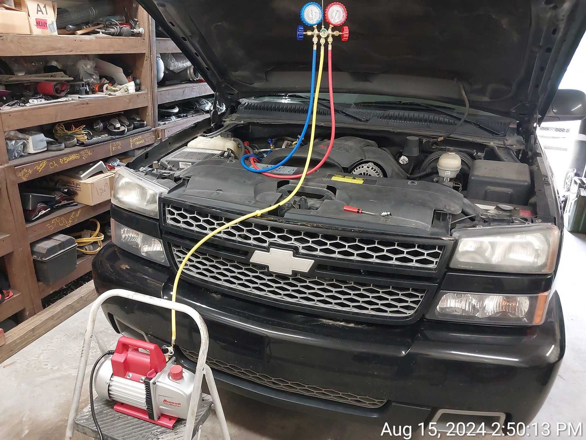

I just did this a few months ago on my 2006, not sure if the part # is applicable to your 2001 but it probably is - verify first. I chose Four Seasons # 26775 and IIRC it's a regular schrader valve in there, just one is a little larger than the other so it's not the same size as a typical tire valve. About $9 from Rock, I needed mine quicker so I got it off amazon for $14 and it showed up the next day. One you replace the whole port, the other you just swap the core. Many regular tire valve core removal tools don't have the reach you need, so I ended up running down to Oreillys to pick up a cheapo A/C core tool (looked it up - Xtra Seal # 15-3174, $6) that worked fine, you can see it sitting there with the black/orange handle. The other trick is the port you completely replace has an oddball socket size/shape (intentional) so you may need to get creative. Can't remember what I used but it wasn't a big deal. BTW recommend wiping a little Nylog Blue on the o-rings to help be sure they seal, and the threads on the replacement port as well. Easy job.
