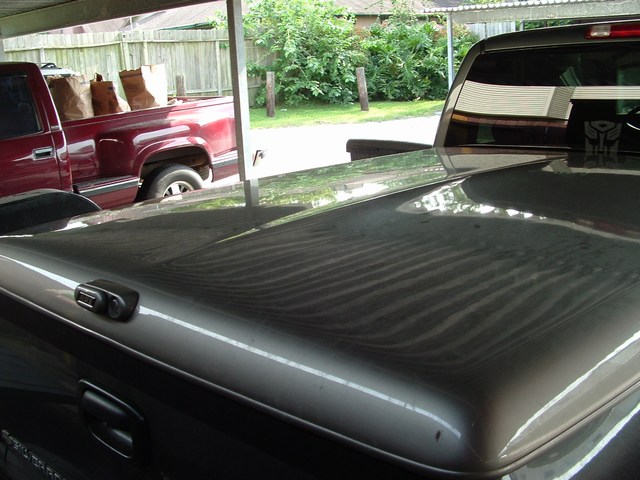

The pictures of my stepside I sent you a pm blank260
Attached Thumbnails Bed swap from rcsb to stepside?-mini-bed.jpg   Bed swap from rcsb to stepside?-mini-fiberglass-cover.jpg   Bed swap from rcsb to stepside?-mini-septside-bed.jpg
