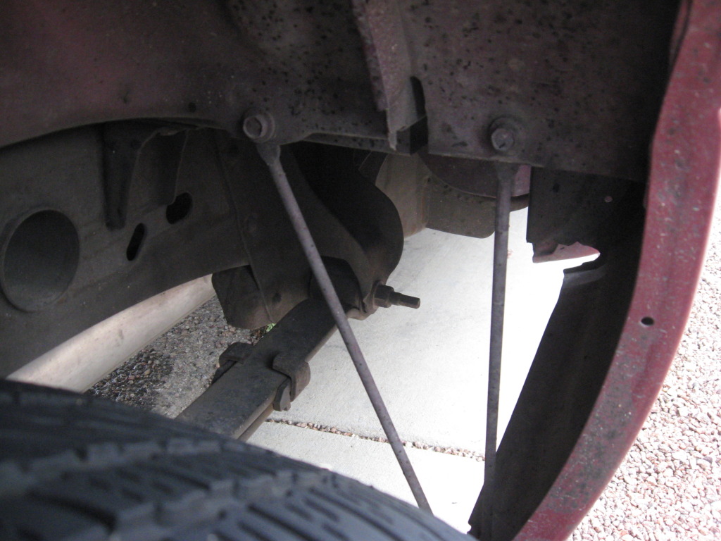

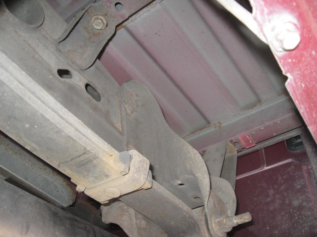

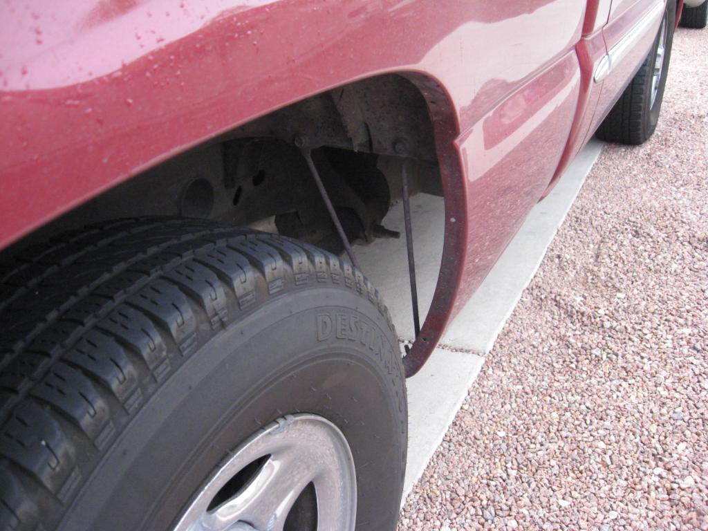

Anyone ever tried it? I'd like to move it out from under the hood to under the bed somewhere. I'm not looking for any miracles in weight redistribution, but rather to clean up under the hood a bit. I really like how Spoolin's PCM is mounted...so I want to copy it now Would give me a lot of extra room to organize wiring, which is what my truck needs the most.
I would put the battery in a waterproof box to protect it from the elements. Best idea for a spot is here, in front of the right rear tire:

I was thinking about putting mine in the bed basically above where your wanting. I measured and it will fit right behind the wheel well and tailgate.

I would prefer to have the bed free, because I still use it often enough. Hauling ATVs, etc. I thought about putting the spare tire in the back and putting the battery right in front of the rear bumper, but that still sort of defeats the purpose. Andy, I would move the battery there too, if I didn't have the nitrous stuff there lol

Hmm, I forgot about your nitrous stuff. Lol. I've seen a few pics of where people move the battery to the inside frame rail. Should have plenty of room.

The is a badass thread on s10 forum where a guy built a really nice set up in that spot for his Sonoma.
Old Jul 22, 2012 | 08:14 PM
A Low Dime's Avatar
13 Second Truck Club
Joined: Mar 2008
Posts: 2,663
From: Arlington (DFW), Texas
I didnt find the build link, but I did find a bookmark of his picture website things. Here are the battery relocation pics.
I believe he just used a thick/big piece of rubber to make a "inner fender".
If you want to see all the pics of the rest of his truck and build, here it is. Turbo GMC Sonoma
