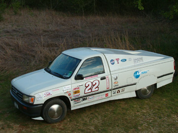

The attached picture looks a little silly but......
