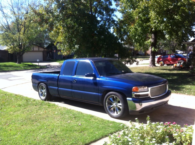

And just for ***** and giggles, here is a pic of it
