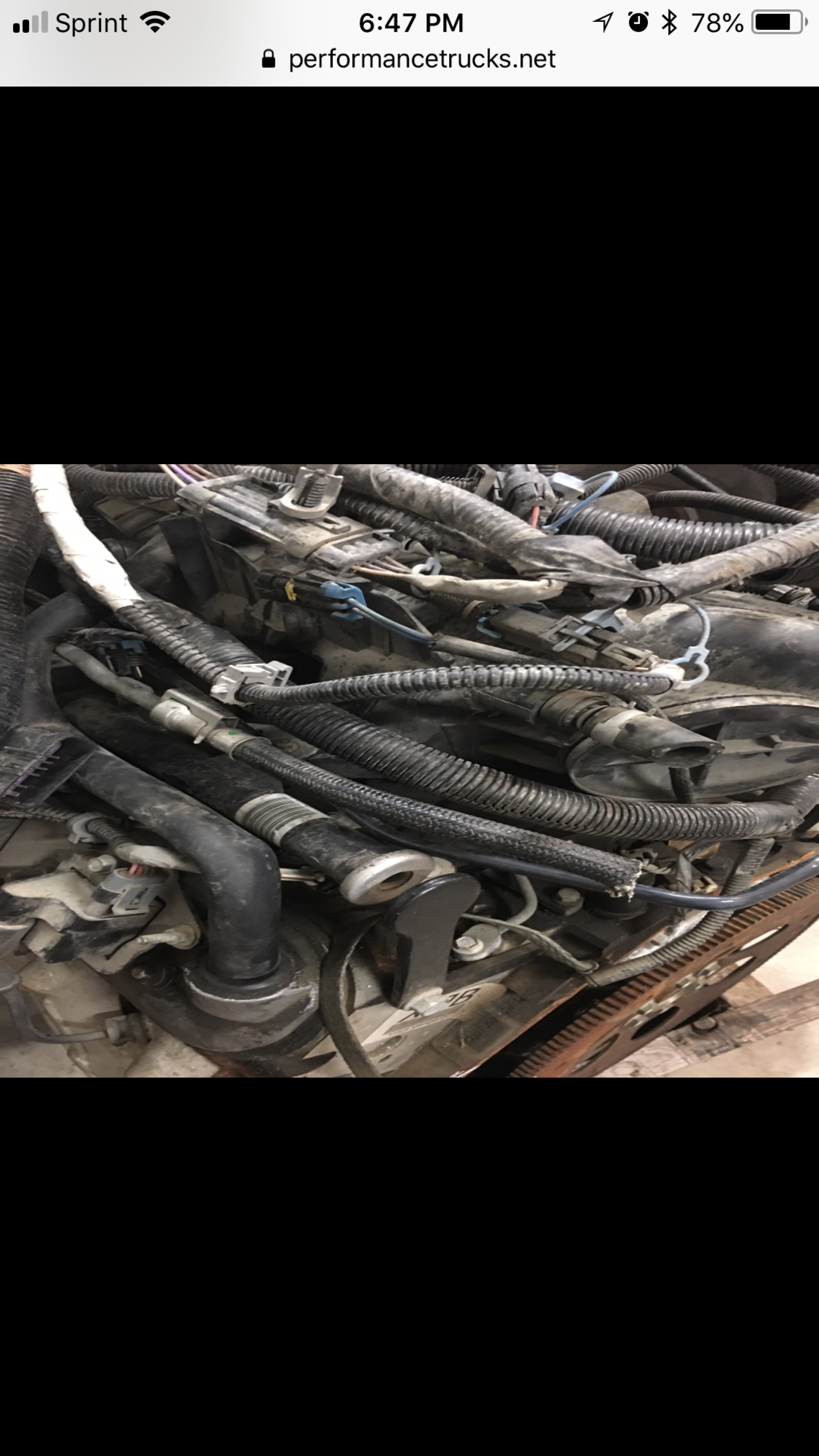

Some more questions: what is this hose/where does it go to located in the back of the intake manifold. Also I believe this other stuff is all Emissions stuff that I can delete correct? Anyone know a part number for what is the plate that covers where that’s located in the intake manifold? I traced this and i believe it follows the fuel line but it has an electronic connection - what is it???
It’s from the truck not the engine.
This is all emissions stuff that I can remove- correct? If I can and I will what part covers the place in the intake manifold?
What is that hose that is cut at the back of the intake manifold?
Different angle/shot of the cut hose at the back of the intake manifold.

The hose at the back of the intake goes to the brake booster. It's pulls vacuum to the booster.
The part in your hand is the Purge Valve Vent Solenoid. It goes to the top of the intake manifold. It for Emissions. It sucks the fumes from the tank through the charcoal canister.
I don't know what is legal in your state for emission standards. It' doesn't hurt anything and there isn't really a need to remove it.
Now being that your truck is an 05, I will say that the EGR isn't needed and can be removed. They were mostly used in 99-01. I don't think on the 1500 series they were used passed 2002 model year. They sell block off plates or you can use later stuff that does not have that.
I only see one fuel rail and line. The picture doesn't show the rail so I can't see if does or does not have a fuel pressure regulator.

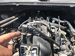

so are you telling me that somehow this^ Evap Solenoid goes to this in the picture below (on the top of the intake manifold)?? but it has an electrical connection - what connects to it? or once I get the correct 03 and up harness it will have an electrical connection for that?

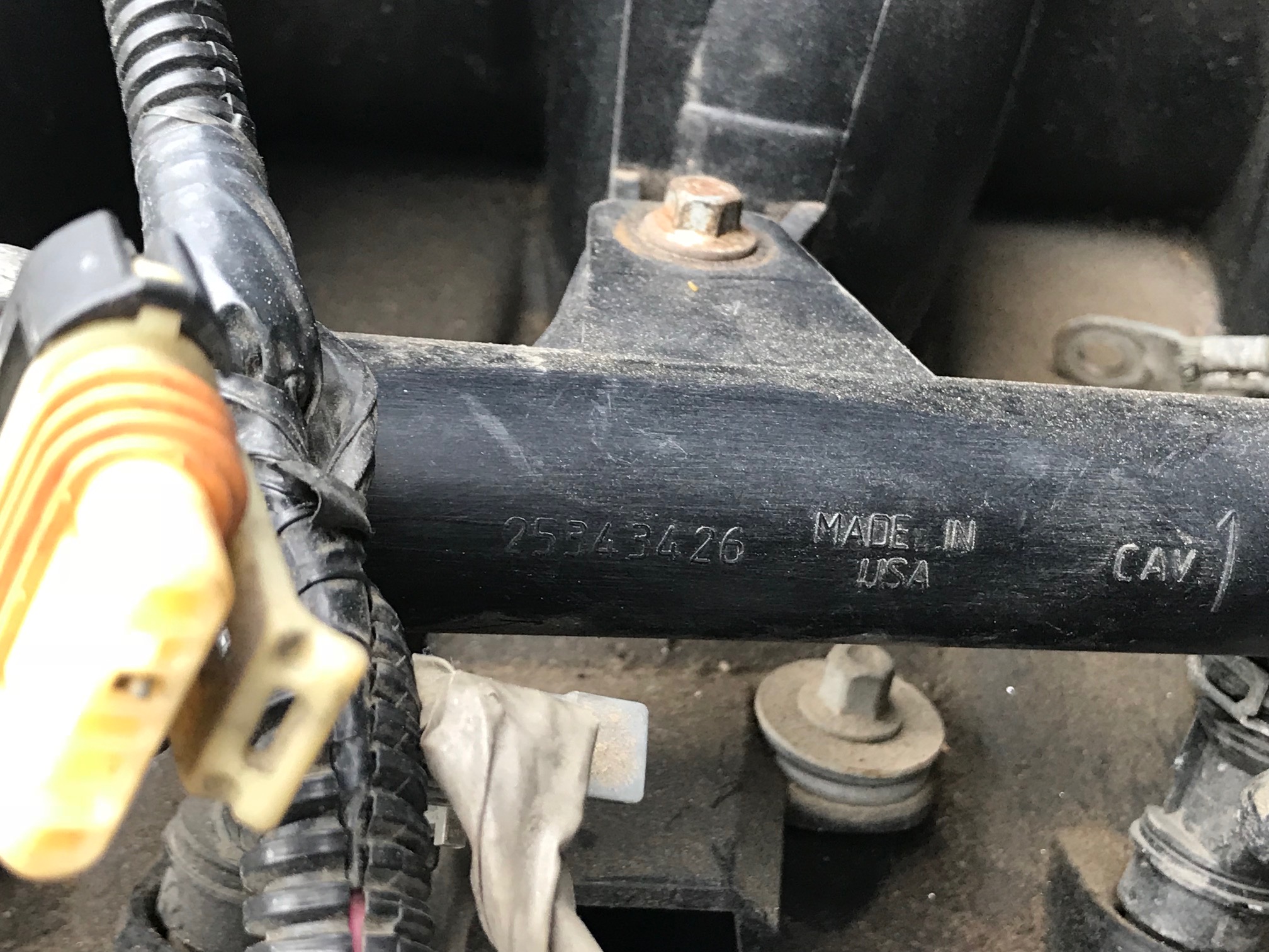

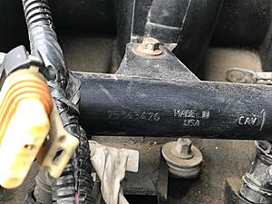

Reloading pics of the drivers side fuel rail. there is a Part number if that helps: 25343426

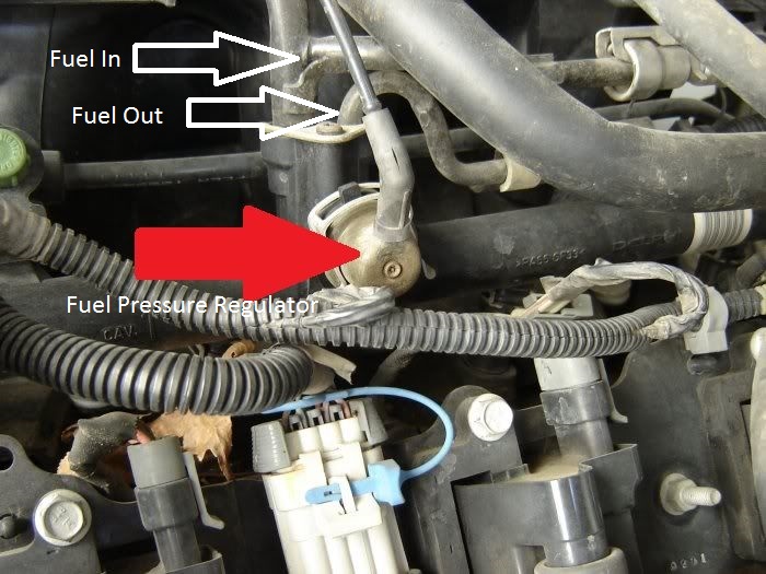

This is the fuel pressure regulator.
Fastbrick - using your own picture I outlined what I think is the Fuel In and Out can you confirm please. see pic below. If that is correct then I don't have the fuel out on my rail.
The hose that you are pointing to attaches to the evap solenoid. The evap solenoid is bolted to the intake manifold.

Yes. You are correct. That is the return. The larger line is the feed and the smaller is the return line. Yes. all years had the Evap purge solenoid. The plug would be on every truck or van harness.

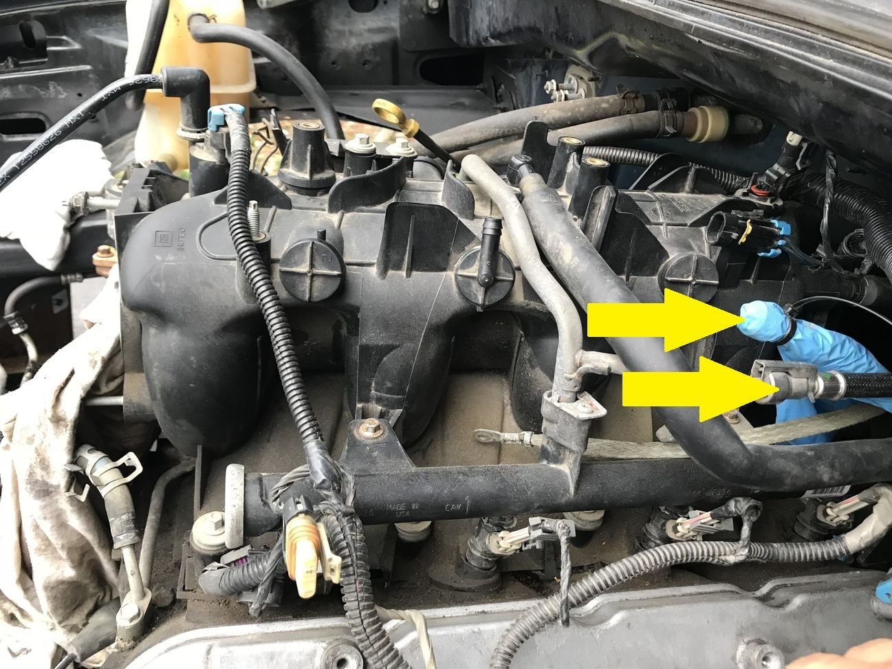

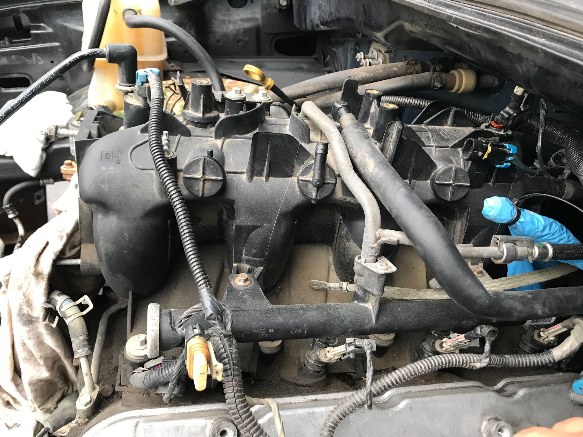

Ok, you see the 2 yellow arrows in the picture bellow? The one is a Feed line which appears to be on the bottom and connected to that rail.
The second is covered by a blue glove. It should look the same with the Black braided hose and the stainless fitting on the end but just a slightly smaller diameter.
Junk yards in general will claim any and everything they can get away with.
The intake could have been swapped by the yard if the old one was damaged. They will always back peddle and claim someone mixed up the tags or labeled something in correctly. The only way to know for sure the year of the engine is to look at the date code. It's cast into the top of the block on the right side above the water pump. It's an alphanumeric code.
Example would be A251
A=January
25 is the day of the week
1 is the year 2001
BTW, I locked the wiring thread. Lets just use this thread for all questions related to your swap. It's difficult going back and forth trying to remember what's posted where. This will keep it simple and easy.
A=January
1 is the year 2001
OK Funny thing about that pic is that the top yellow arrow is pointing to the Fuel line from the (back) truck - reason I covered it with the rubber glove because we were smoking cigars while removing and reinstalling the engine so I didn’t want the fumes and cigars to interact with each other (BIG BOOM). The bottom yellow arrow is pointing at the fuel line that was cut from the JY and I left it attached to the fuel rail while installing to ensure no damage to it. Soooooooo with that said I only have one fuel line coming from the back of the truck and one fuel line on my fuel rail. Sooooooo I should be able to plug that single fuel line and connect the EVAP purge hoses and be golden - right???
