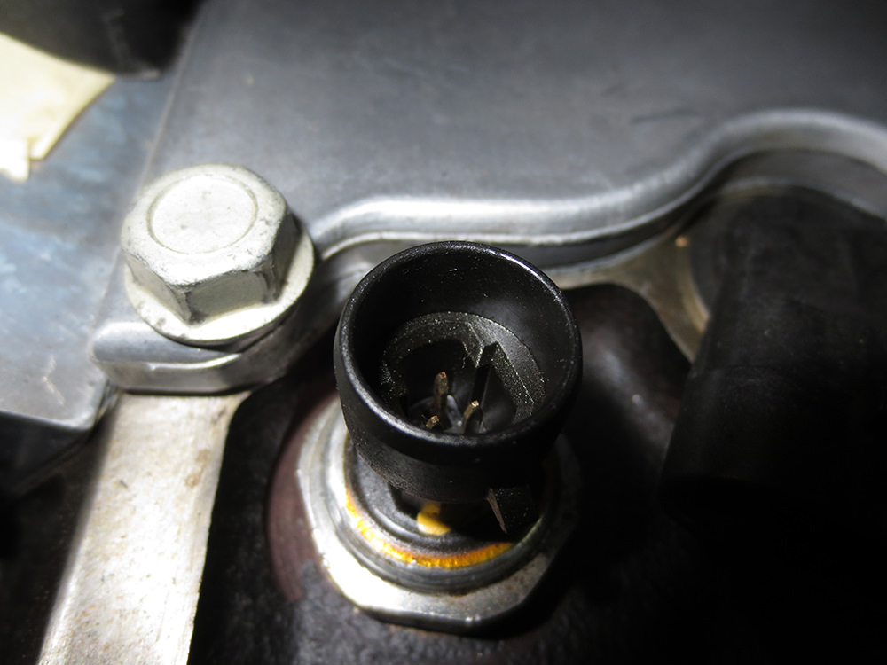

One more thing is the oil pressure sensor is also different between 99-02 and 03+. The 03+ oil sending unit is a three pin connector whereas the 99-02 has a single pin... I have the 03+ but need the 99-02 and you'll need the 03+ oil sending unit, dam thing (99-02) is $38 new
03+ three pin on my LQ9

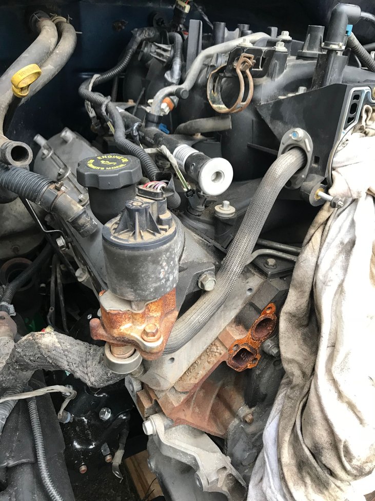

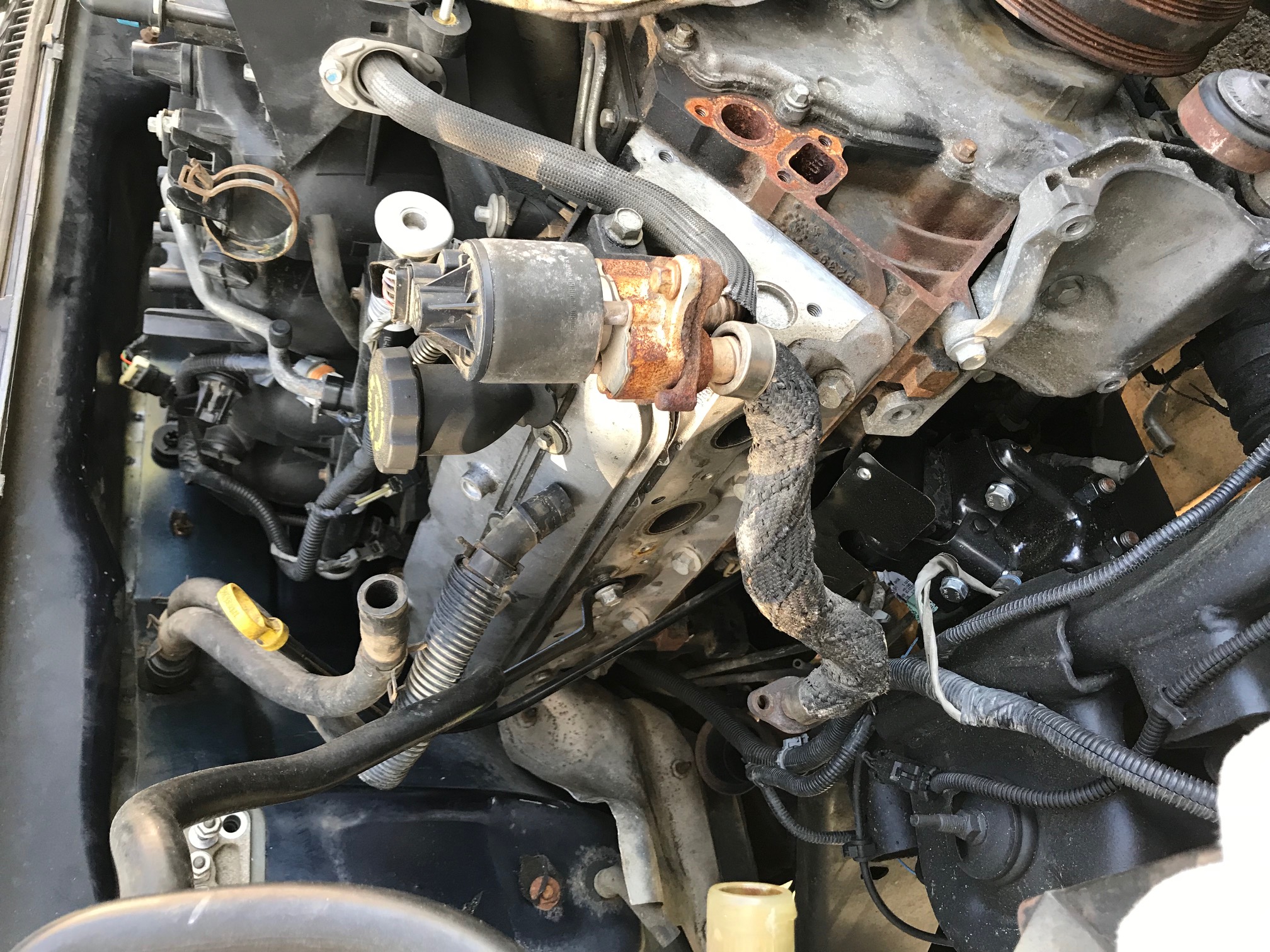

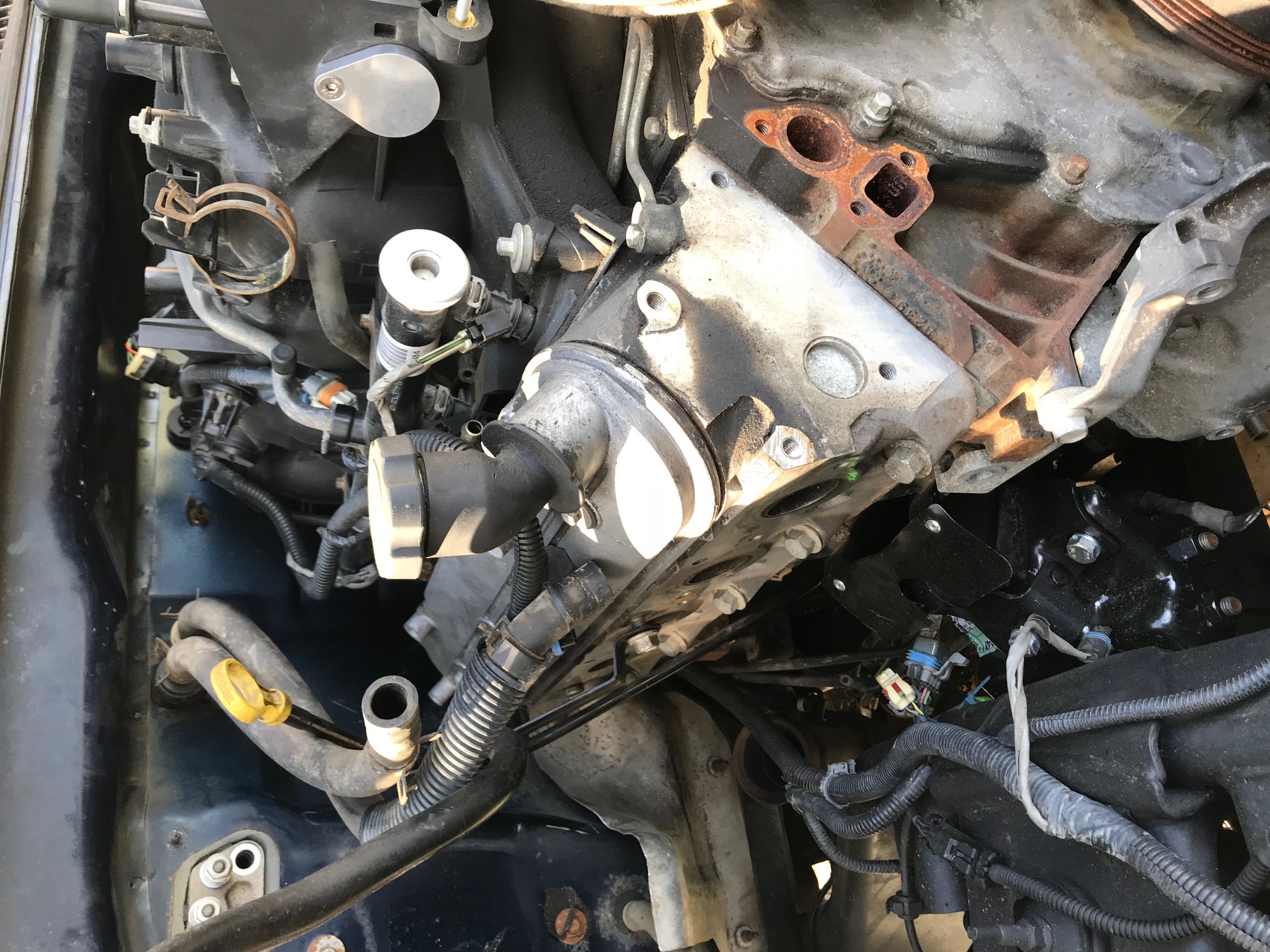

ohh and I also cleaned up the engine some, yesterday I received the cover. removed all the EGR "CRAP" looks much MUCH better without it. I am getting closer and closer.

You got lucky finding the harness already set up for DBC. I also wondered if the oil sending unit from the 4.3 will work but RockAuto shows two different part numbers. Check your new harness to see if the oil connector has three pins or one. Since someone did harness work they may have already addressed that oil connector.
