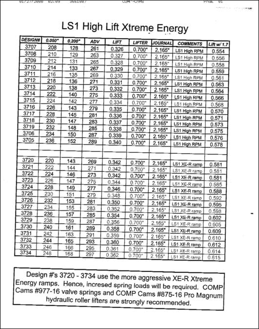

You have a 350 in your Tahoe? Is that even an LS1? Hmm. Anyway, if it is, you should be able to get away with something a little bigger than the 206/212. You can basically design your own cam from Comp, they have XE lobes going from 208 on up. For instance, you could make a 208/212, a 208/214, a 210/214, etc. I've attached their lobe sheet so you can have a look and see what they have available.
No the tahoe is not LS1 based, that's why I posted in general truck topics, not the 4.8, 5.3, 8.1 performance forums. I know most of the guys on this forum are life long Chevy guys, as am I, so most have had the Vortec 350 and may have had the same conundrum. I will call Comp if and when I have to replace the gasket.
