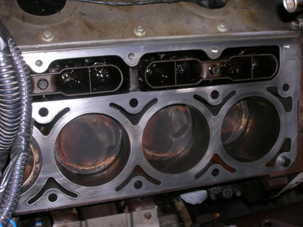

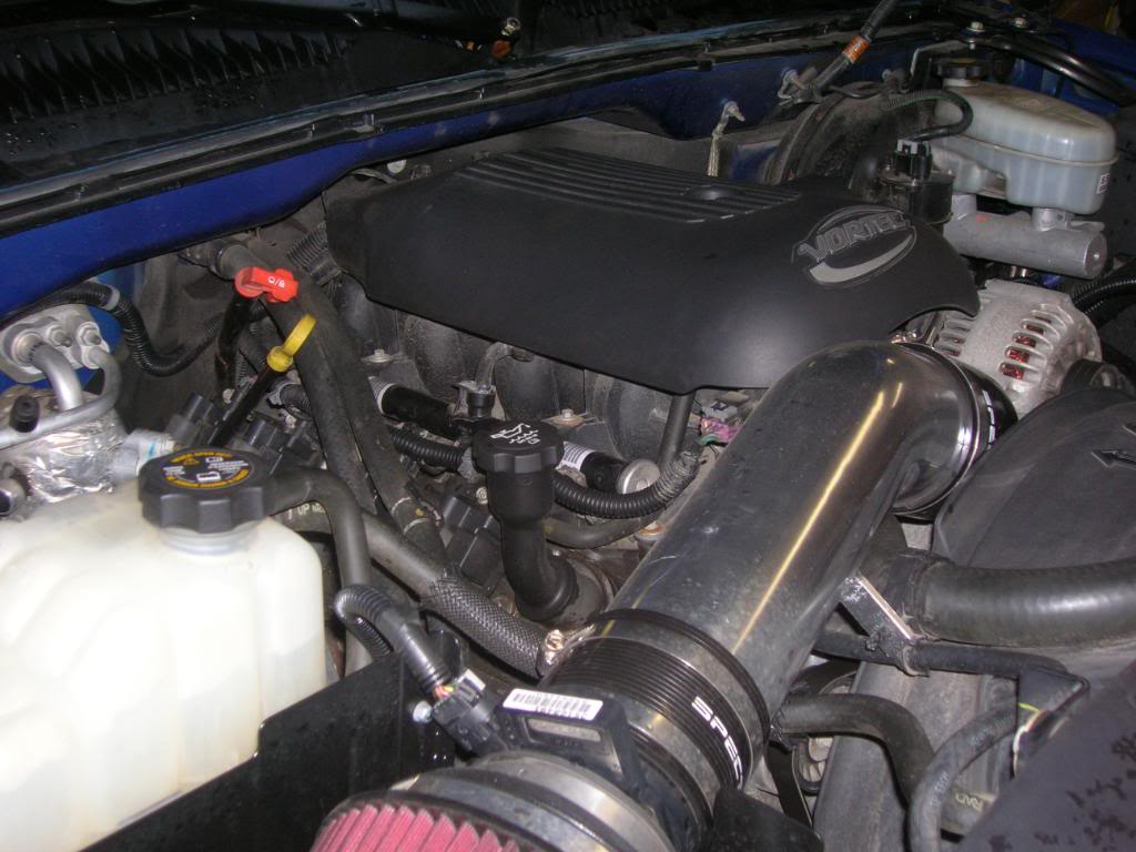

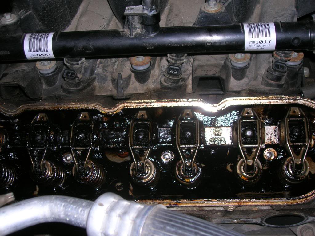

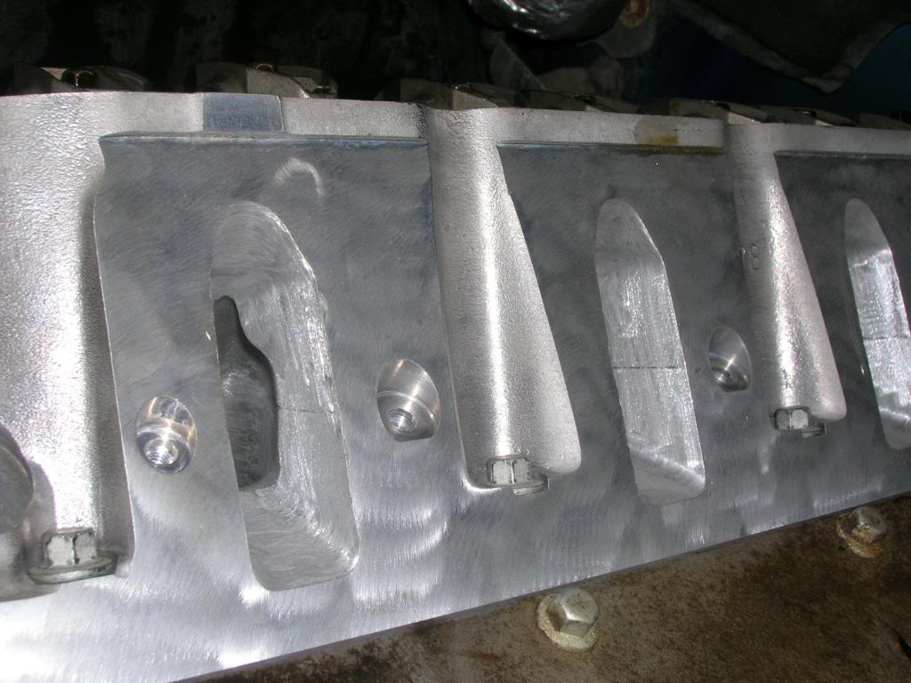

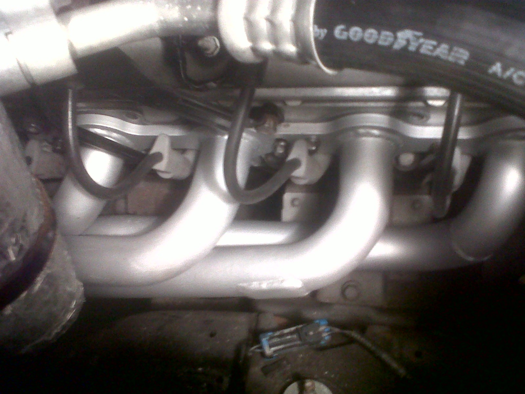

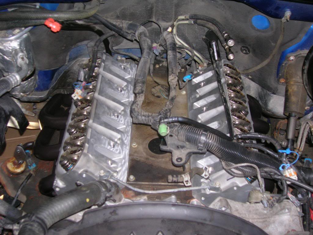

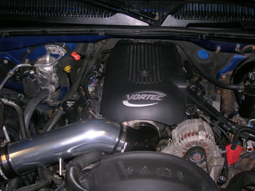

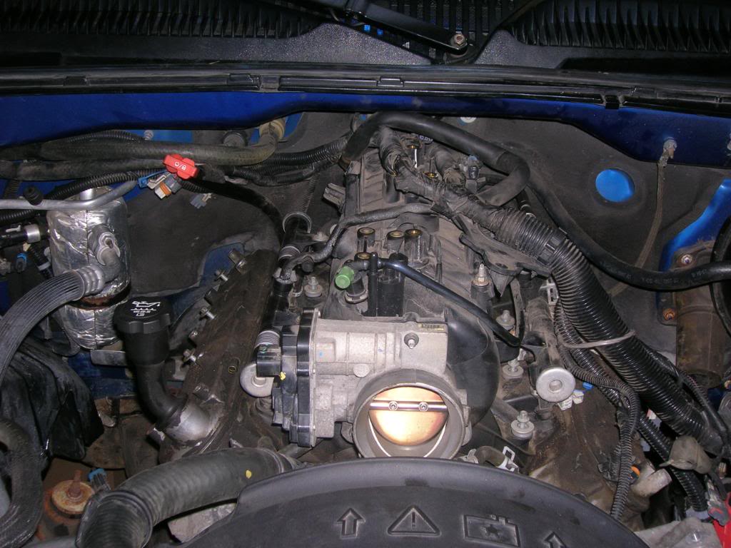

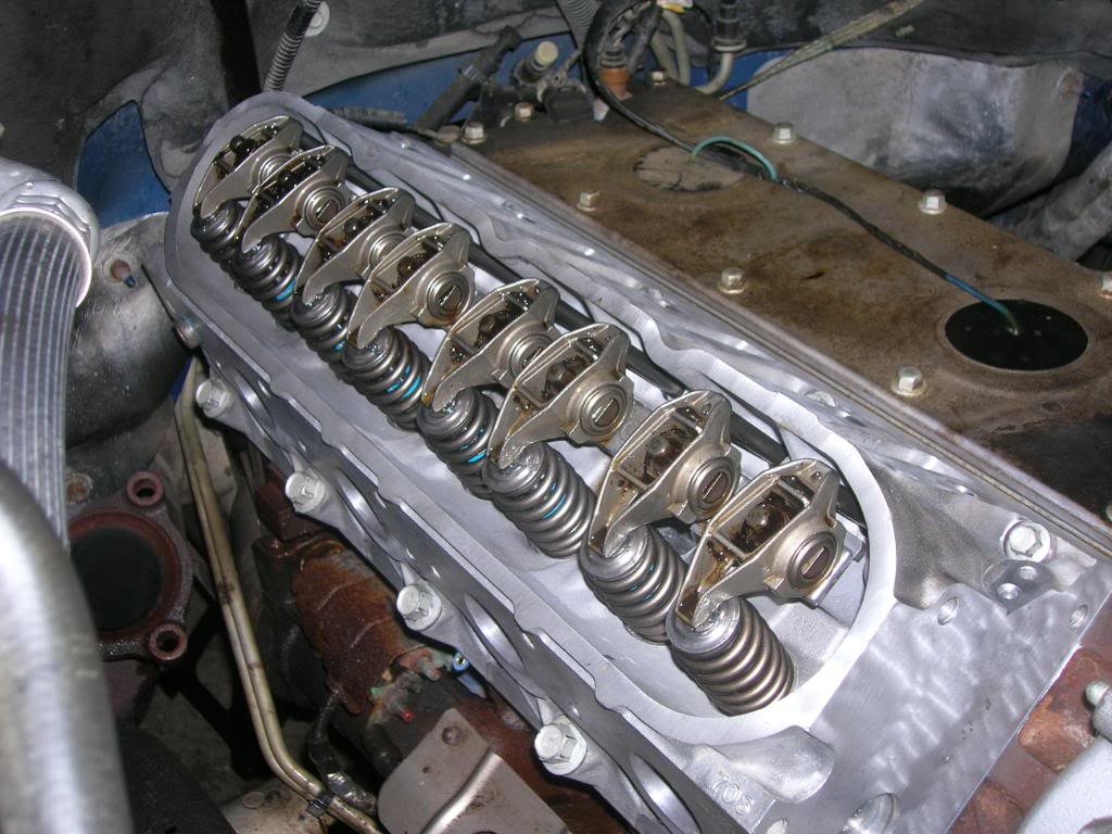

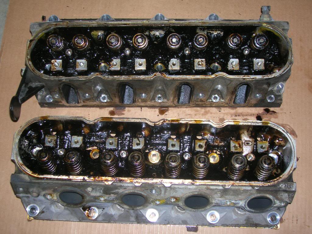

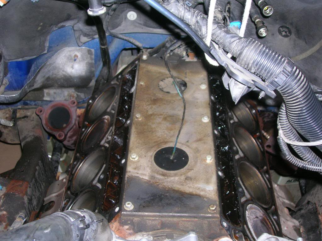

hey guys, just figured i would share my experience with my coolant loss problem and hope to hear some of your stories and experiences on the subject.i also hope to help people that might have this same issue and have no idea about it.Anyway, long story short, i bought my truck used with 50k and started to lose coolant somewhere.it didnt drop much but enough to notice and for the life of me i couldnt find any leaks i even changed the water pump to be sure...not it...it turned out being a crappy casting on where the cylinder head bolts to the block.needless to say about a $3,000 job at the dealer which they would only pay 10% of which is total BS. but it needed to be fixed so i ended up buying reman heads for $400,gaskets/head bolts $250,various other parts about $100 and spent the weekend with my dad tearing it down and cleaning and cleaning and well you get the idea...then installed and run royal purple with mobile 1 filter and shes runing great now...forgot to mention i have 105k on her now...oh and while i had the new heads i ported them (20 hours) and installed some shorty headers...the reman heads were great for the price...fully loaded with new valves and springs/keepers.so here are some pics for guys like me who like the visual...also i threw a p0420 couple of times recently...just wondering if the exposure to the burning coolant wrecked my 02s and cats...im thinking of welding on some thunderbolt metallics and new denso 02s.anyway here are the pics...enjoy...and by all means chime in.Name:  03GMCSierraHeads016.jpg

Holy chit! That is some nasty buildup under those valve covers!!! U ever hear of seafoam? Nice looking heads btw...

BTW the shorties cleaned up good! Did you paint them?
