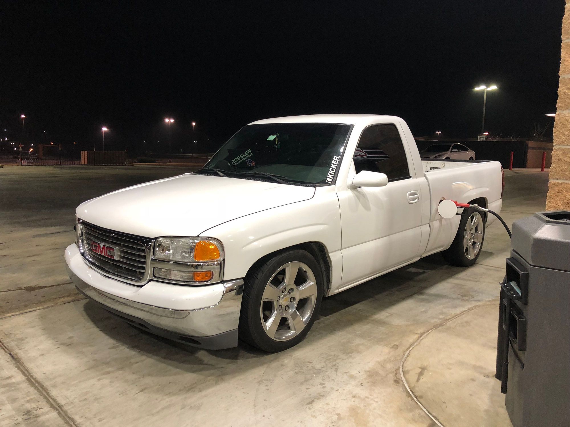

I introduce you all to, ShopTruck.
It's a 2001 GMC Sierra. My buddy and I built this truck back in 2013. Started out life (as we knew it) as a real pile with a need for lots of body work, a 4.8 and no transmission. We went to a local salvage yard and picked up a 4l80 with converter out of an old at&t van so he could drive it. The stock 4.8 on the bottle obviously wasn't cutting it so he decided to build a healthy 408. We pulled the 4.8 while waiting for the 408 build and had his dad do all the body work to make this thing look new again.
Fast forward to January 9, 2018. It is now mine! When we picked it back up, it wouldn't start, the Bogarts that my buddy had put on it were sold for $300 and it was sitting on chrome stock bullet holes, and the truck was just an all around mess. So we took it back to the shop, pulled the intake, cleaned the intake runners, intake, injectors, put new plugs in and fired right up! Also put the late model silverado wheels and tires I had from my other truck on it while we were there

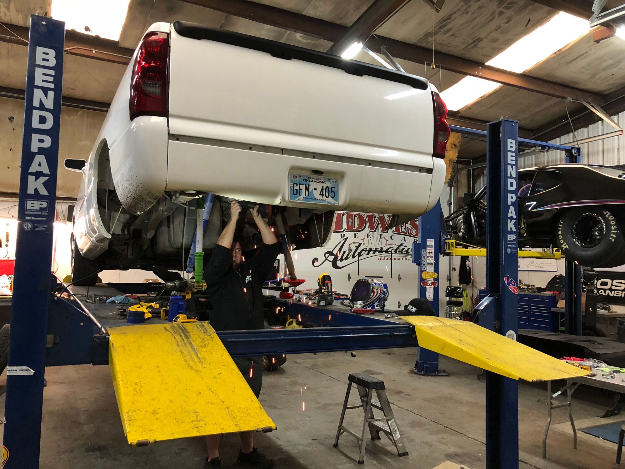

It set a little higher in the back end than I like. Luckily, the rear end from my truck wasn't damaged in the fire. So we took it out and put it in this truck.

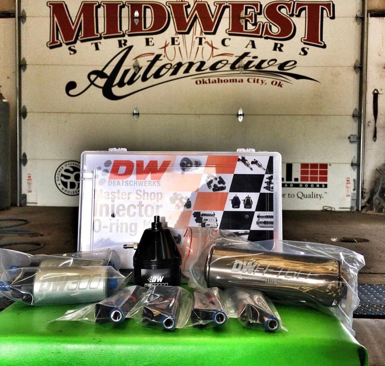

Now that it was running and looking better, I was able to start working on the tune since it was never really finished before. Did a bunch of drivability tuning and got it driving very nicely. Then decided to go WOT...120% IDC. Since I couldn't really remember what we did for the fuel system 5 years ago, I decided to just replace it all. I had #95 injectors, 450 pump, and 10 micron filter from Deatschwerks left over from what I planned to do with my last build, so I through it all in this truck. New fuel system front to back with -8 feed and return. It was a trick to get two -8 bulkheads in the stock bucket. Wish I would have taken some pics of that as it actually turned out nice.

Haven't really had alot of time to mess it recently as its either been too cold or we've been too busy. I did manage to sneak it in on one of our track rentals and make one pass. I was so excited to just finally get this truck down the track, I didn't even check tire pressure. It was somewhere around 30psi lol. Anyways, managed a 1.72 7.65 at 91mph. Would prolly translate into a high 11.9x at around 115mph. Pretty much exactly what I expected with what I'm working with currently.
Current setup:
11.5:1ish 408
SDPC L92 heads
ebay 3.5 CAI
Vic Jr.
elbow with 92mm ebay tb
91 octane
1.75" pacesetter headers
crush bend 3" dual exhaust
bone stock 4L80 with single disk converter that flashes to 4200ish rpm
8.6 10bolt with Yukon helical posi, Yukon 4.11 gears, and Yukon axles
Flipped with 2" shackles out back
Cal-Tracs
Lowered with springs and spindles up front
Custom Kicker stereo system with 2 10" subs, amp, equalizer, and in-dash dvd/nav
Truck weighs 4520 with me and 1/4 tank of gas
