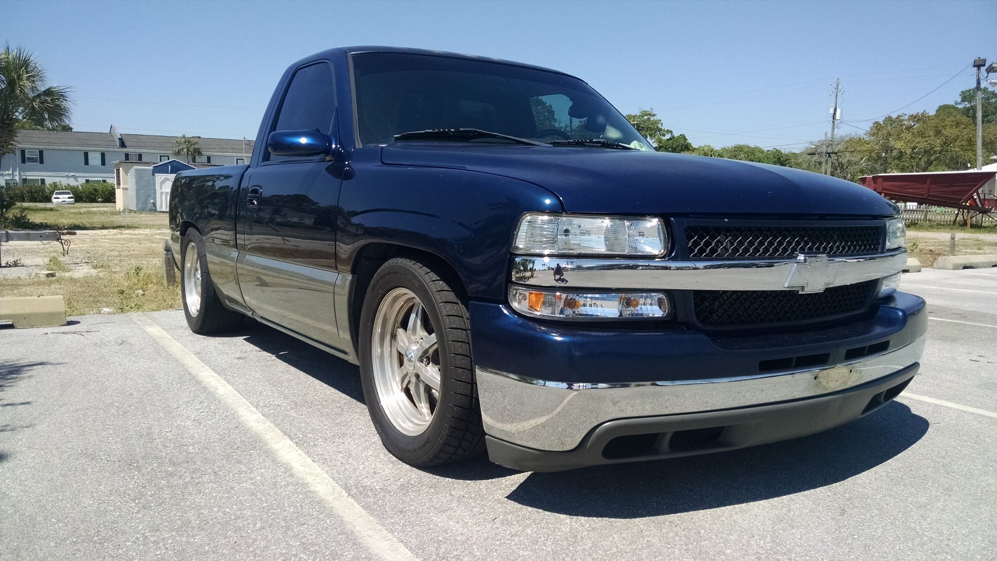

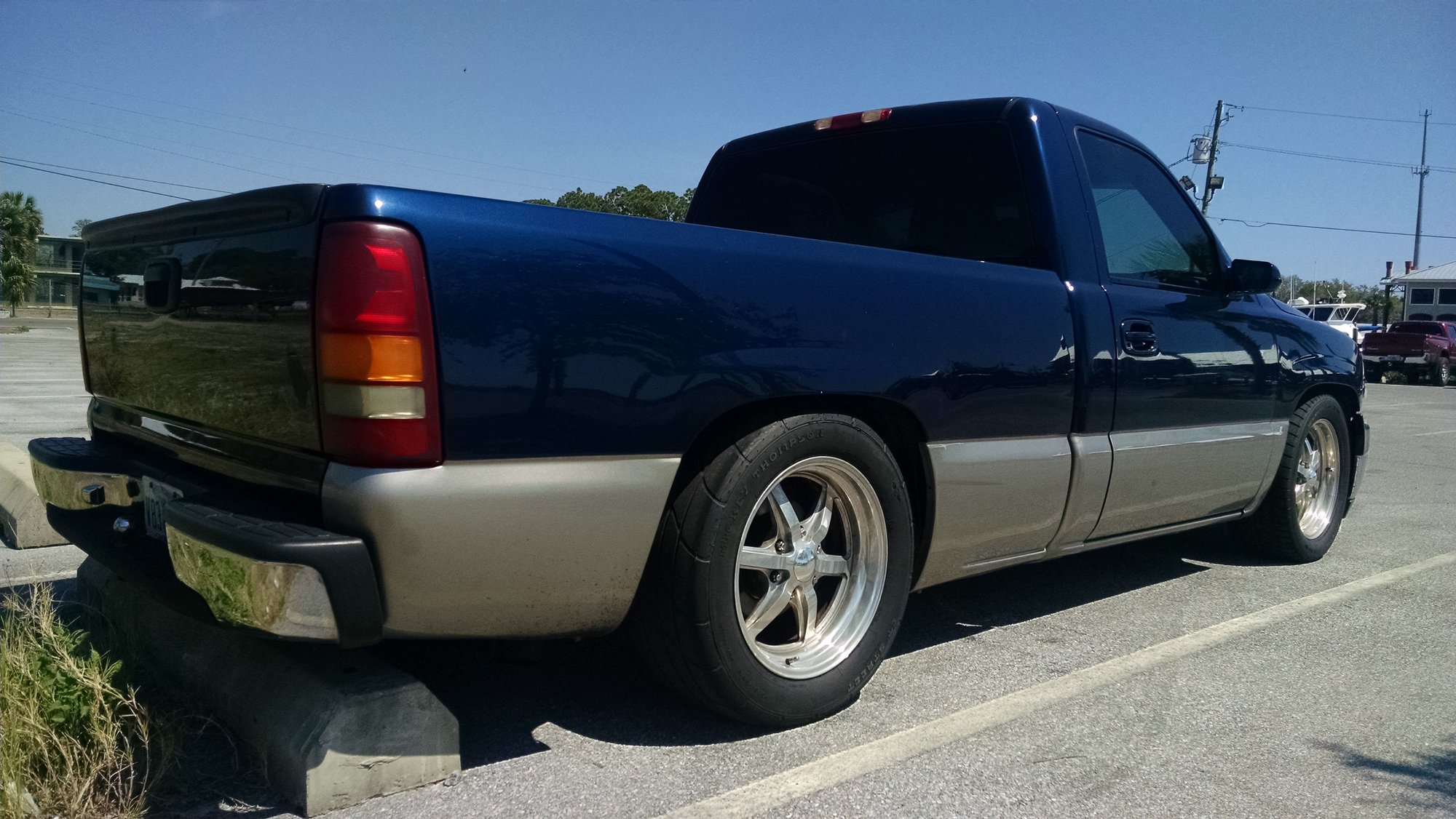

I'm running 305/45/18 on 9.5" wheels out back on a flip kit with traction bars. I had to roll the fenders to keep from rubbing before the tracbars but no issues since. Running a 265/50/18 on a 8" wheel up front but also have another set of 9.5" with 295/45/18 on them for autox. Should have some recent pics in my built thread here. (link in sig)

Truck is dirty but these show the tire/drop better...
