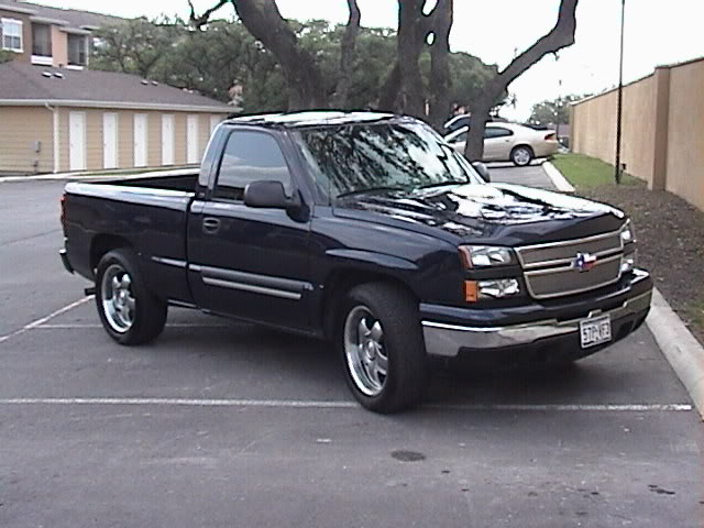

i know my tires were 285/50, but not sure on the width of the wheel, 8 or 8.5

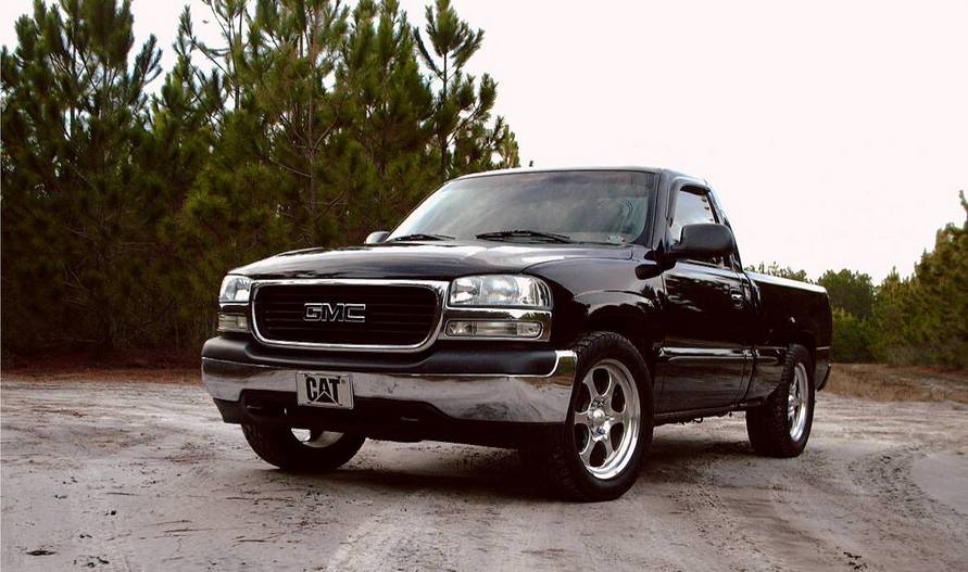

285/50 on an 8" wheel; 3" rear drop:
You ever weigh that setup or happen to have the overall height? Did they stick outside the wheelwells at all, it almost looks like they do just slightly in that pic? 20x8 w/ a 5" Backspace I guess? Was considering running that setup w/ a 1"/3" drop
I never did weigh them; the tires were heeeaaavvvvyyy though considering the size. The overall height on them was 31". The tires were about even with the outside of the fenderwells; I'm running a 275/45 now and they tuck front and rear with the rear fender lips rolled so it's not the best offset but its ok.
Thanks for the info. Yea all the 285/50's I have seen are running around 39-44 lbs. Still not terrible w/ a 24 lb Stingray III tho. Did you rub w/ the 285's at all? And did you notice a big diff in acceleration/braking when going from stock to the centerlines?
I did notice a difference in acceleration with them; you really need 4.10's for that size tire. They didn't rub at all; I was going to do a 2/4 with them but ended up going with a smaller tire and a 3/6......and trust me, they look awesome on a 2/4 and won't rub except maybe on bad bumps.
