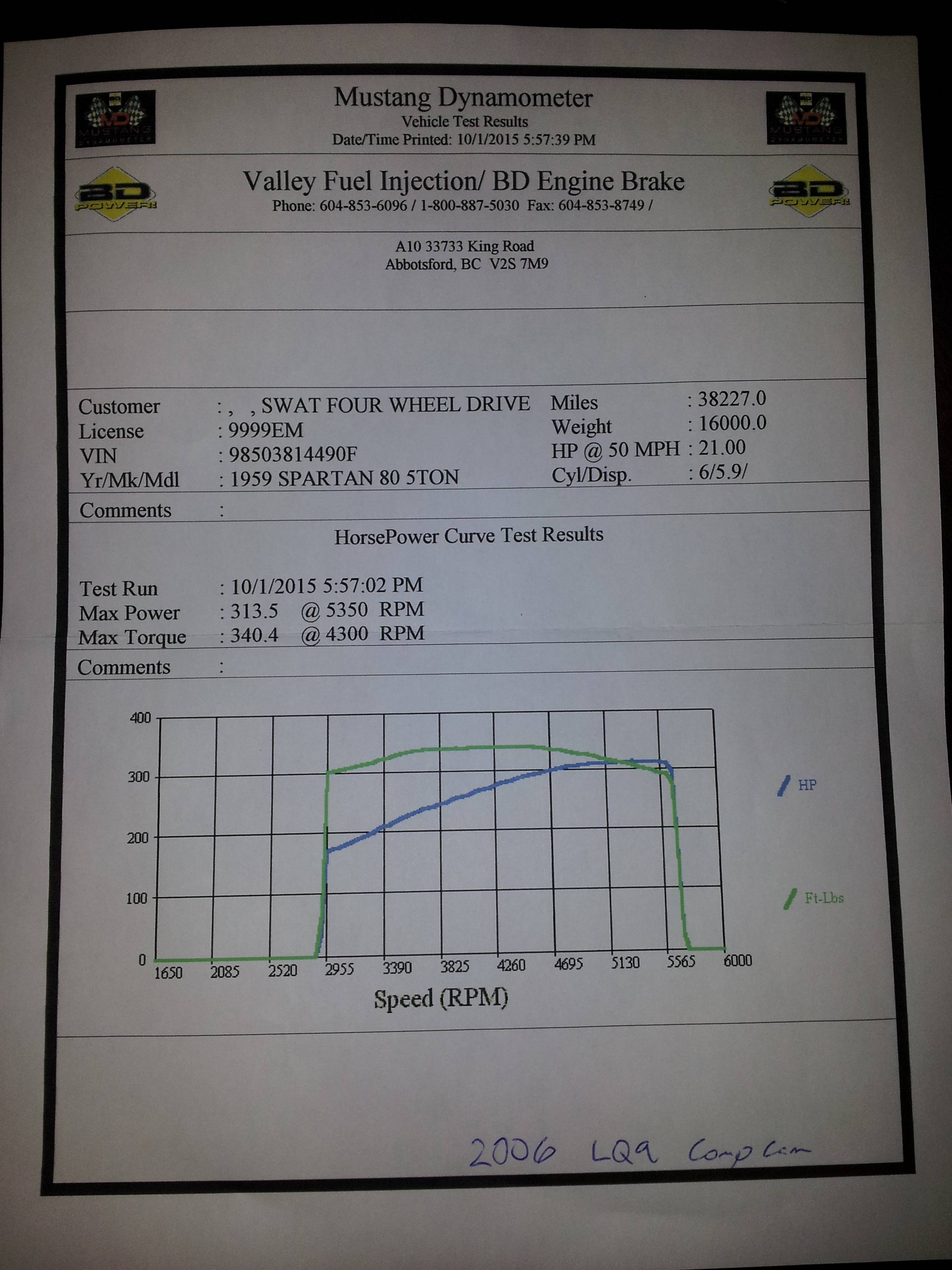

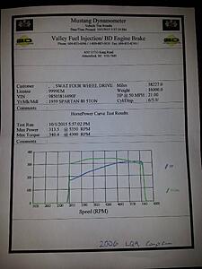

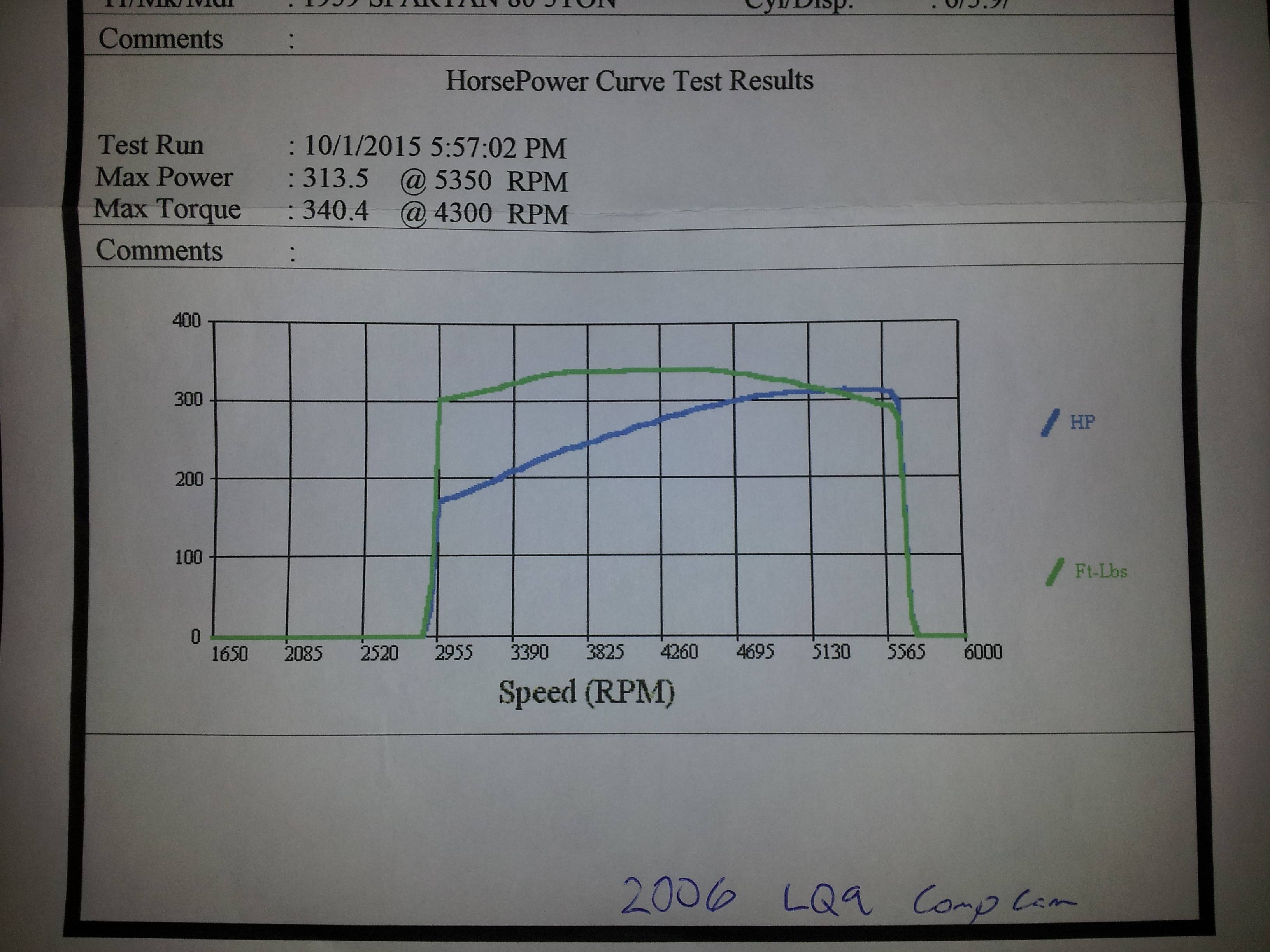

Snuck it onto the mustang dyno at work. That dyno is a heart breaker and reads 100 hp lower than most inertia dynos. Also had to run in 3rd 4th is too fast for the tires at 6000 RPM
What does everyone think? does 300 to the rear wheels suit the mods or should I be looking for more? Also btw ran one run without the K&N filter and gained 15 HP! Anyone have suggestions to a higher flowing filter than K&N???
Let me know what you guys think, Is she down on power or on par for Kooks headers, Y with Cats, 3" exhaust, Tune, Mild Cam, Air Aid Tube....
Thanks!
(Ignore the Spartan on the dyno sheet, it was on the dyno earlier that day, we still adjusted parasitics for my wheels)
