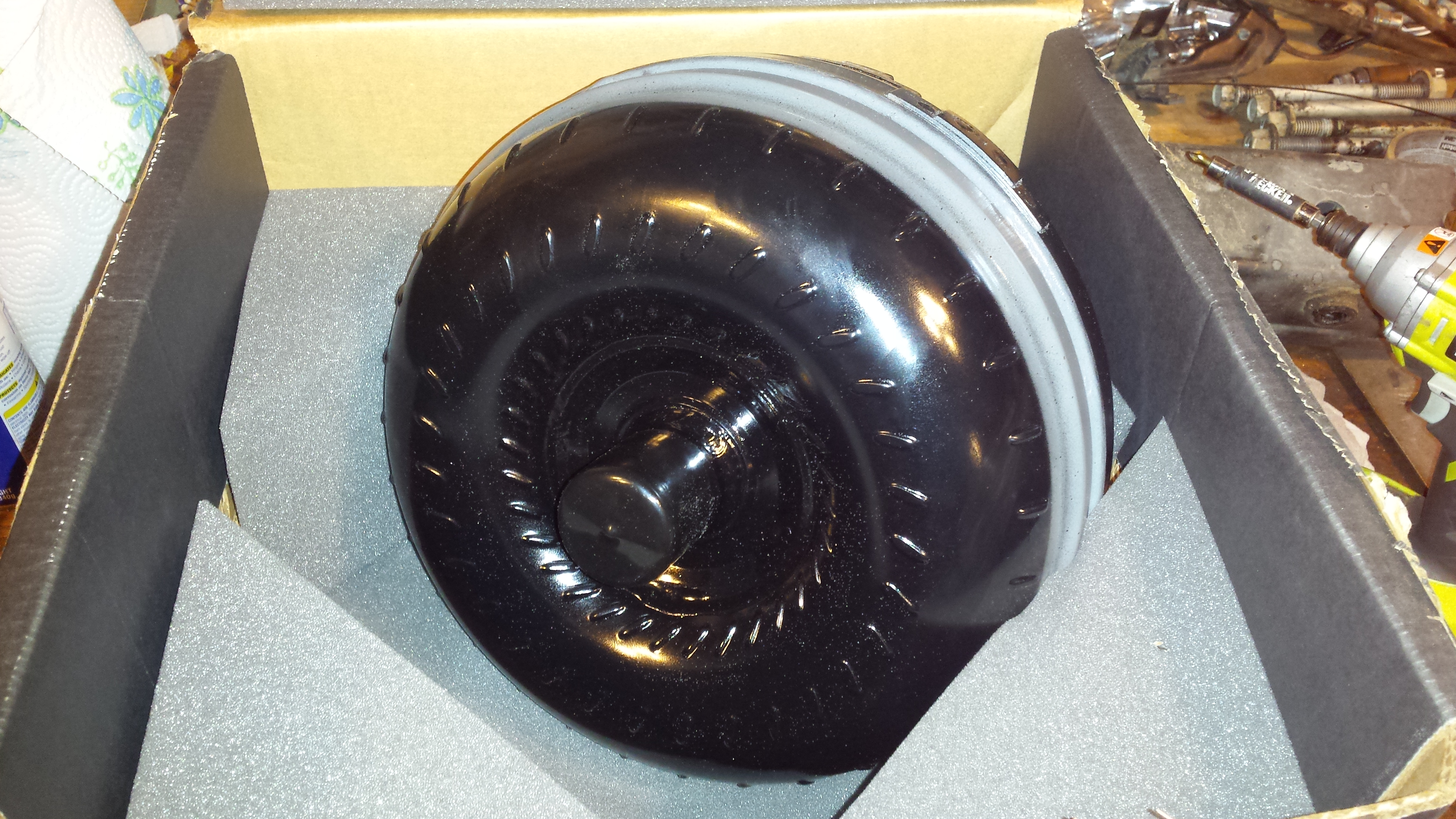

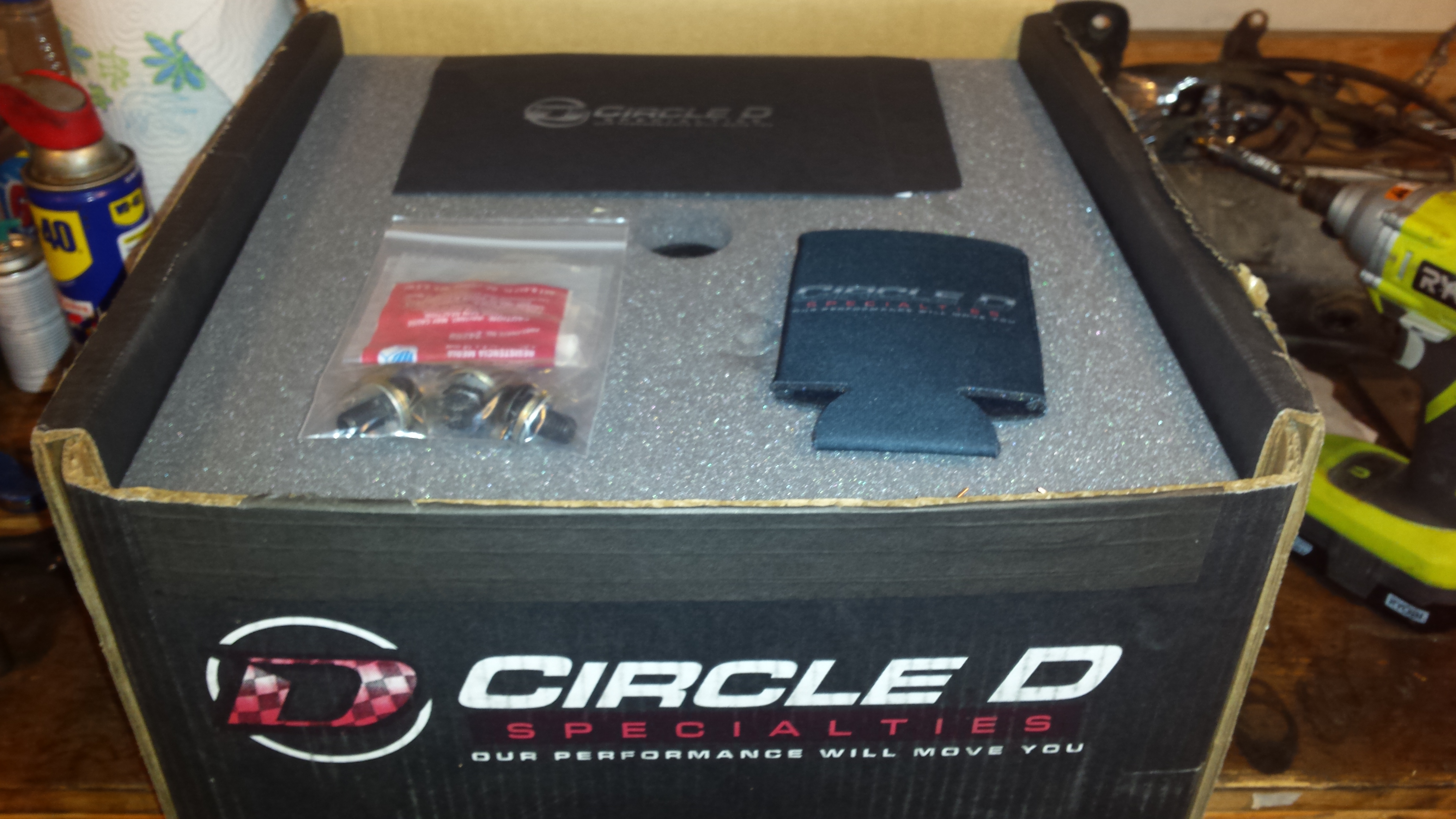

Size:  2.52 MBName:  20160518_114620_zps4sjkfatj.jpg
Size:  4.05 MBName:  20160518_114702_zpsqnpdvpdd.jpg
Size:  2.91 MBName:  20160518_114832_zps70ft7hyh.jpg
