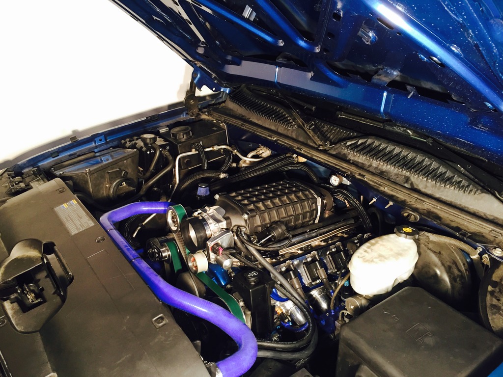

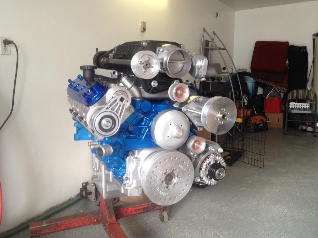

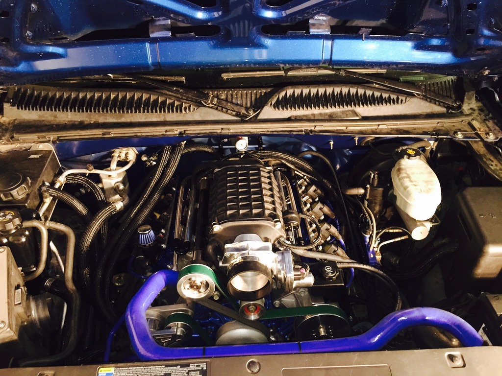

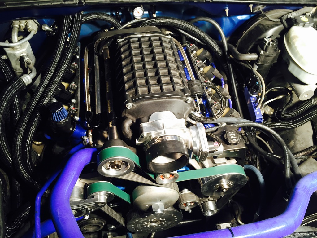

Old Nov 9, 2015 | 03:20 PM
MID12sSSS's Avatar
Joined: Aug 2013
Posts: 65
