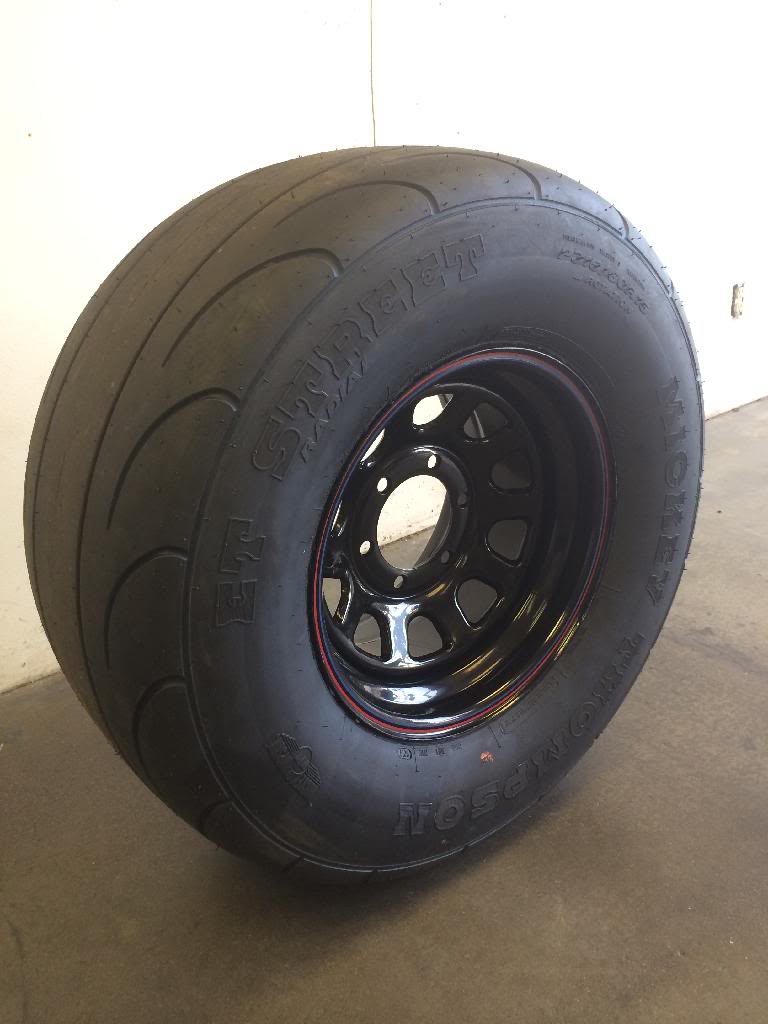

Mounted on a mickey 315/60.

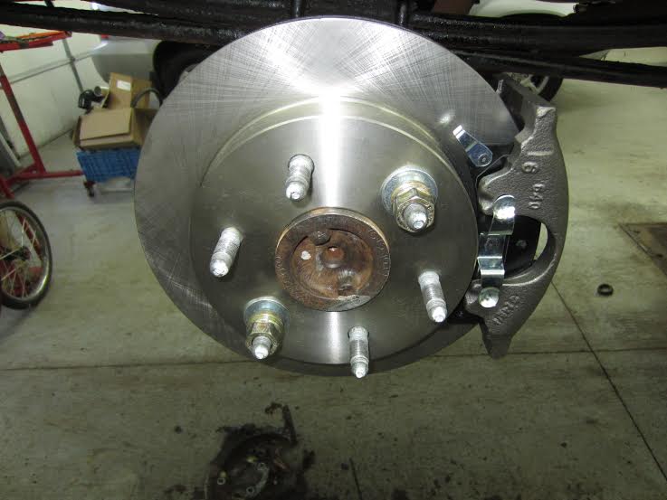

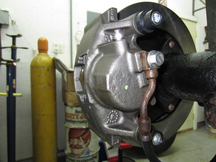

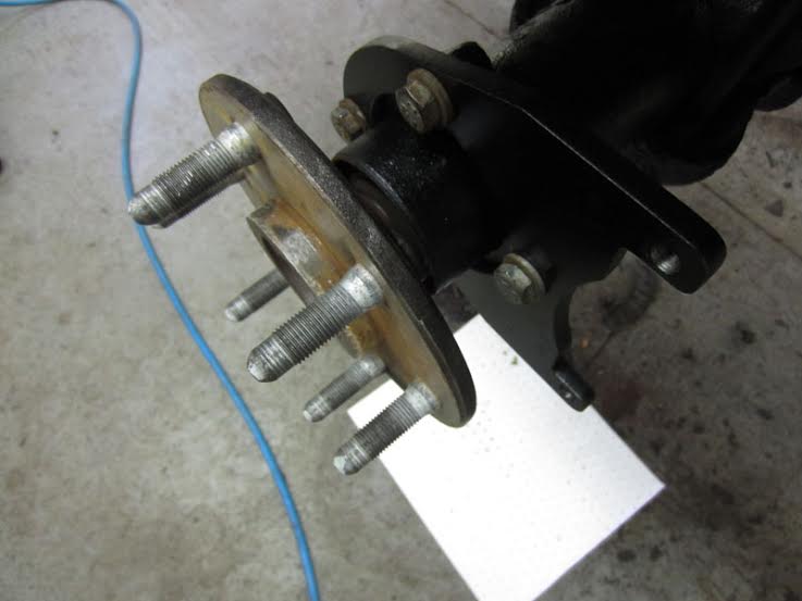

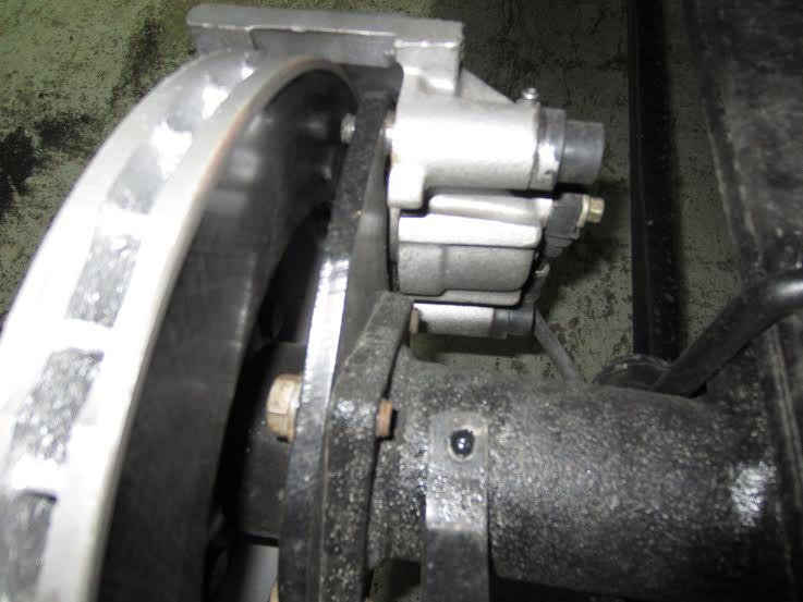

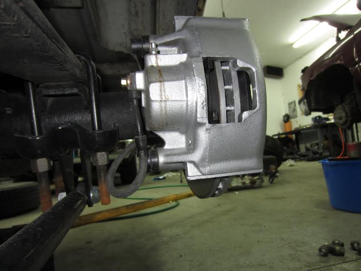

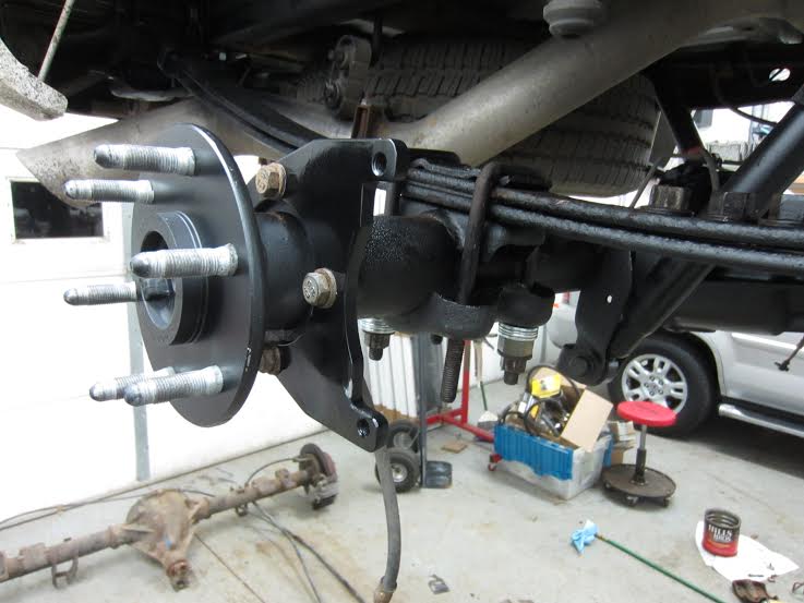

Ok guys, Johnmaster1 gave me permission to post these photos. All you need is the custom backing plate and everything else can be bought off the shelf at your local parts store (K1500 1" thick rotors and calipers). He said that the stock banjo needs to be slightly drilled out to accept a slightly larger banjo bolt but otherwise stock works. The caliper bolts need to be slightly ground down so they don't hit the rotor. He torched off the stock backing plates and the custom backing plate he made was 2 piece so he never had to open the differential and pull the axles out.
I'm really hoping we can get someone to manufacture these brackets. It's seems like it would be pretty simple and would once and for all end the 15" wheel issue on 99-04.
