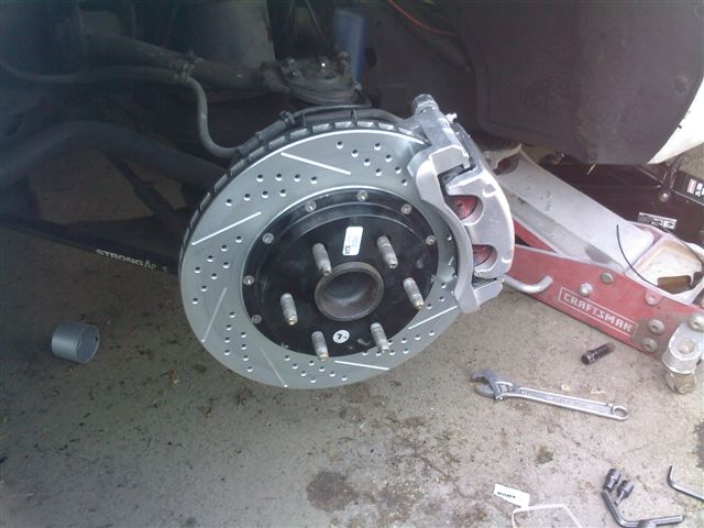

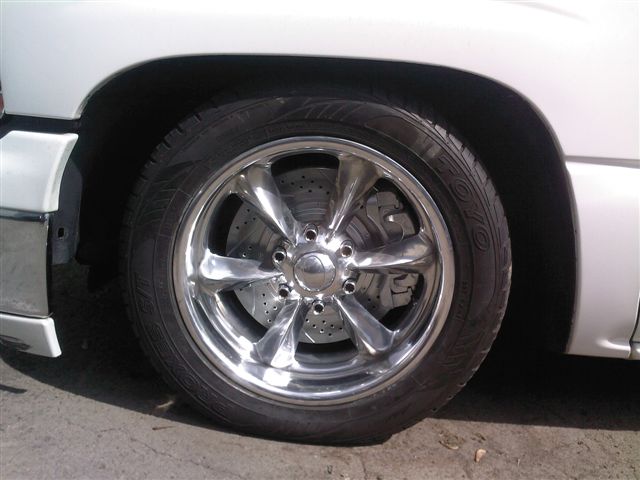

Well it works but took a little grinding on the caliper and a tiny bit on the wheel too. Oh yeah flush valve stems are a must.
The old power slot rotor & caliper bracket weighed 25 lbs the Baer stuff almost 29 lbs, the better stopping power should make up for the add unsprung weight.............
Attached Thumbnails 14" rotors w/ 18'' Boyd Smoothies-pin-ups-017.jpg   14" rotors w/ 18'' Boyd Smoothies-pin-ups-018.jpg   14" rotors w/ 18'' Boyd Smoothies-pin-ups-019.jpg

Looks great. Congrats on getting it done.

Thanks man, try a picture again..........................
Attached Thumbnails 14" rotors w/ 18'' Boyd Smoothies-pinups019.jpg

looks real good. Is your valve stem on the inside of the rim?
yeah most likely i know my boyds are

Yes they are, thats why the flush mount stems. Got them from Summit if anyone's lookin.

Looks like a nice tight fit. I assume the previous powerslots were just stock replacements? Any reason you went with the baer + size over the powerslot + size?

Didn't know they had a Powerslot + size? I bought the Baer kit on ebay for 330.00 shipped. They are a 2 piece with aluminum centers too.
