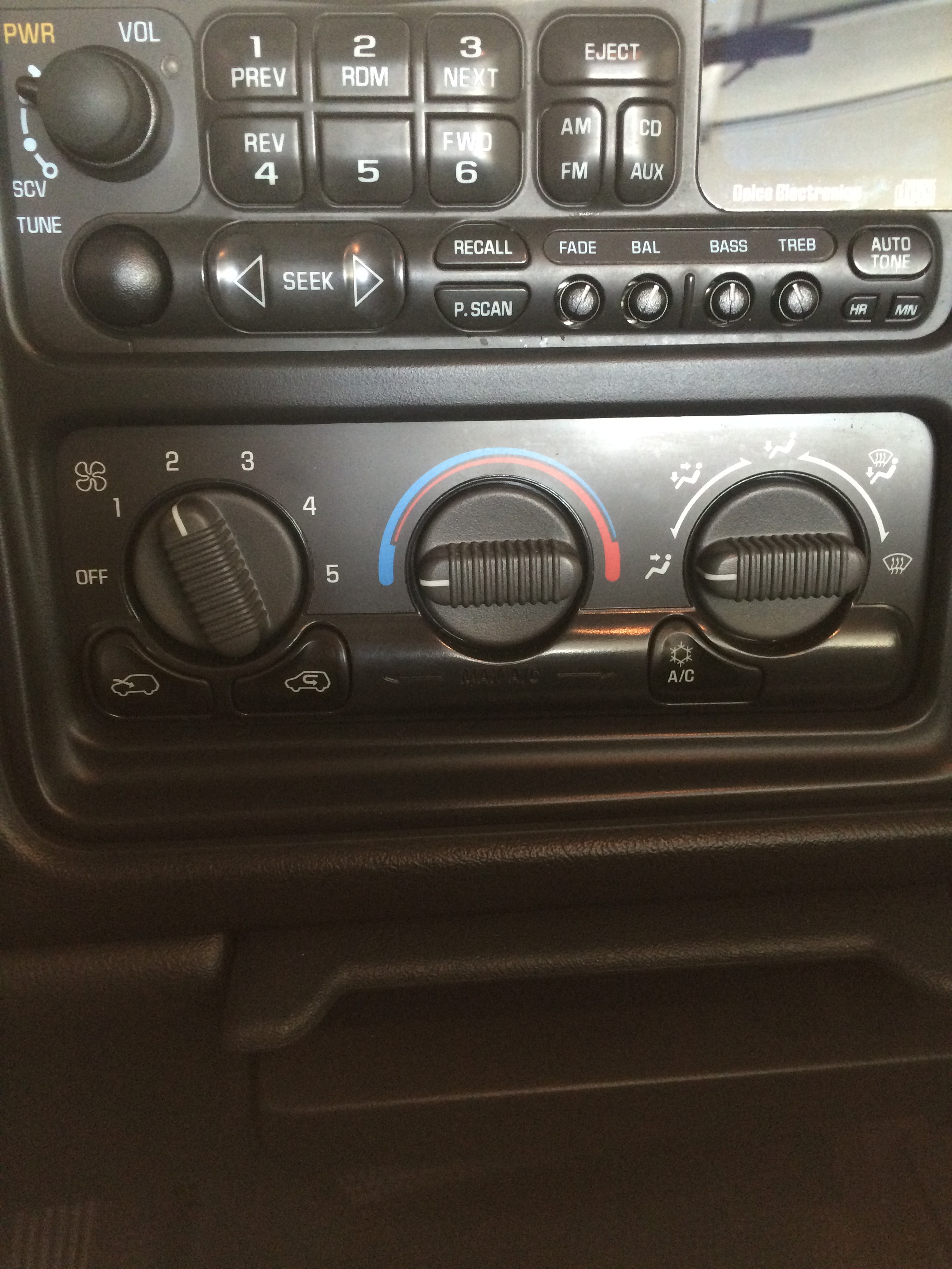

It is an electronic one. Not sure on the auto AC. Here is a pic.

That one is sensorless and not computerized. It will start AC on every time, requiring you to disable the AC until the next ignition cycle.

Wow, that it weird.
btw.....how did you tell? The one in my '01 Silverado looks almost identical but it doesn't start A/C every time.
Also, can I replace it with one like the control on my '01, or is there more to it that that?

If the system is off the ac shouldnt come on, if the ac button isnt on the compressor shouldnt kick on. That is a simple old style system that is either shorted somewhere or has a faulty ac switch in the control head, i have seen the clutches short themselves out and come on constantly......

The temperature **** is a blend **** instead of a temperature specific positioning and the blower **** is a fixed step speed (resistor-based instead of PWM).
The BCM controls the AC Relay state, the button just tells the BCM to disengage the AC relay. The PCM has an AC relay override (can force relay off).
The AC light should not come on if the fan is switched off, though. If it does, you most likely have a defective control head.
