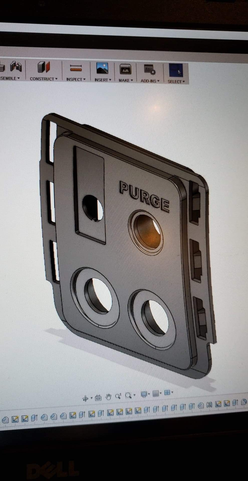

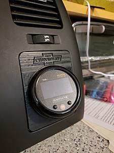

Nitrous switch plate I'm making for someone. Doing this in ABS plastic. Had to re-design the whole part to accommodate the finicky material. New parts will be of this new design, that also improves the surface finish/layers etc. I have also thought of reducing the upwards tilt (and recessing the standard gauge pod design at that angle) due to issues I'm having on my personal truck with visibility on a bright day due to reflection.
