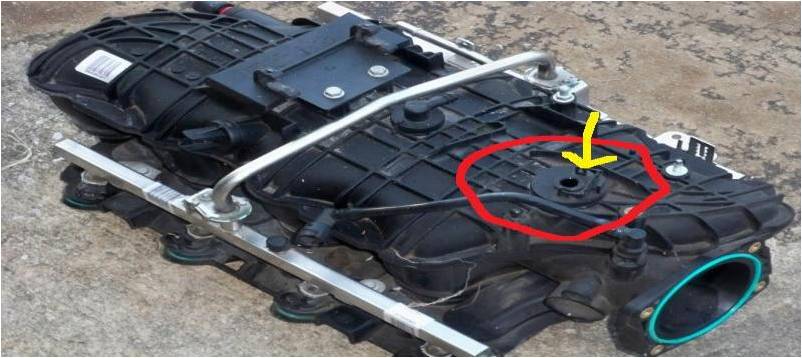

What goes here? This is not my intake but I got one that looks just like it , just not sure what goes here.

that is for the map sensor. It is on the back side of our intakes. you can either get in extension harness, or you can just open up the harness and pull some of the wire out because there is more than enough wire. That's what I did. In Post #2 in the 2nd pic, you can see the sensor and the wires renning to it.
