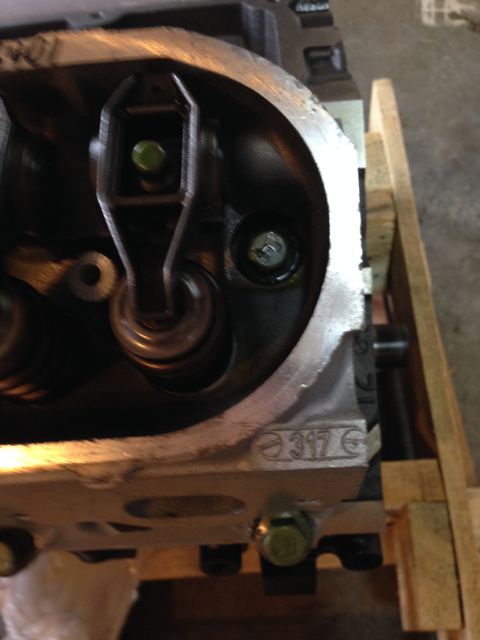

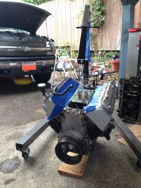

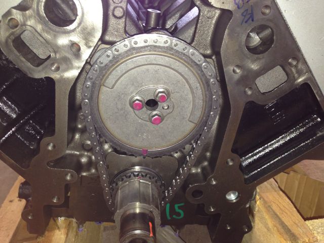

Engine is in!! I had a few set backs like not putting gaskets on the coolant pipes that sit on the valley cover and I broke off a quick disconnect on the heater hose....fun stuff like that. I still need to put the 8.1l injectors into the manifold, prime the engine, and swap the PCM when my tune from Nelson Performance comes. So I'm hoping Friday I will be able to fire it up!! Here are a few pics:
