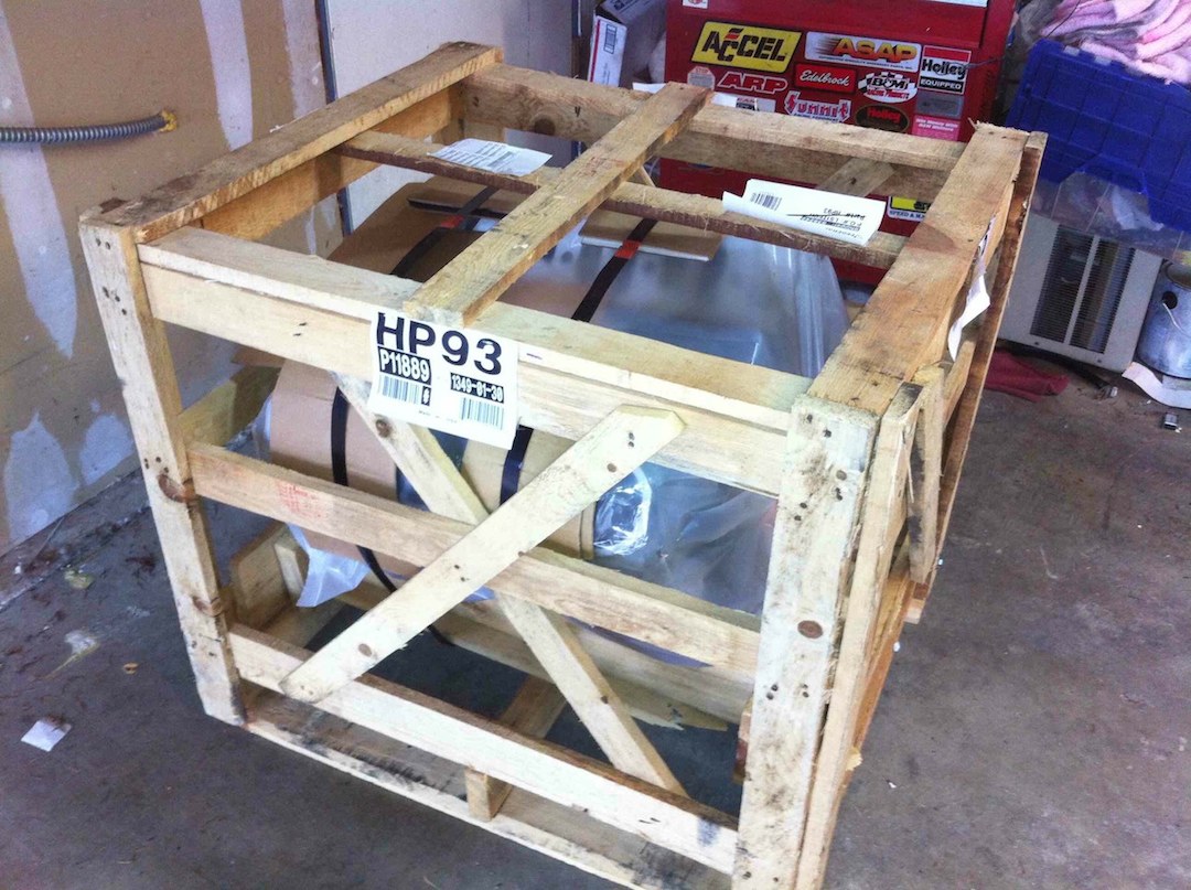

Default Look what showed up today!

Looks like a pile of scrap wood... Let swing by and pick it up so you dont have to look at it when you get back
Old Jun 26, 2014 | 09:54 PM
Flyin 1500's Avatar
Joined: Sep 2005
Posts: 75
From: Federal Way, WA
Dude, feel free to swing over and unpack it for me. Help your self to the beer in the kegerator too!
Old Jun 26, 2014 | 09:58 PM
1FastBrick's Avatar
Custm2500's Rude Friend
Posts: 14,599
Likes: 902
From: JunkYard
Then there won't be anything left for you to play with...
