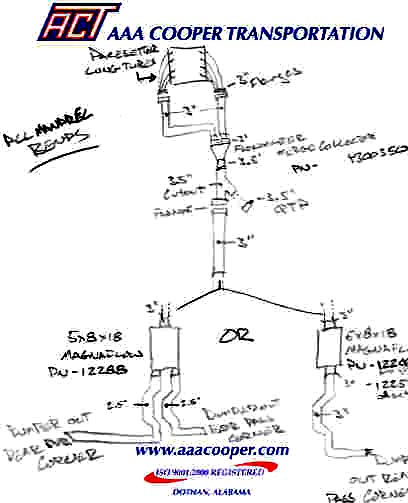

To the best of my knowledge, the Pacesetter Y-pipe is not coated. Secondly, since I am having the rest of the exhaust done, I can have my exhaust guy build me one for less than the pre-fabbed pacesetter which is not guarenteed not to need modifications to fit. Plus I have recently recieved information from a competant engine/exhaust buider that the flowmaster merge collector will work just as good or better than any thing out there. So here is what I believe I have set my mind on:

kenny, if you want that manual cutout i have you can have it. i know you want electric tho. just looking at the sketch and it has one in there. would serve it's purpose for the time being if the install didn't cost too much till you got an electric one.
