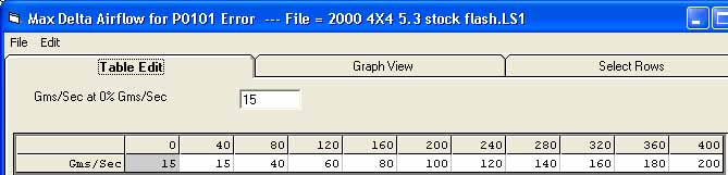

The allowed error for the MAF is lower at lower MAF readings. The higher the MAF reading the higher the allowed error is. Looking at the P0101 Allowed Error table in LS1Edit that's what it looks like anyway. That's probably why you are setting the code a part throttle and not at full throttle. Here is a pic of the table.
