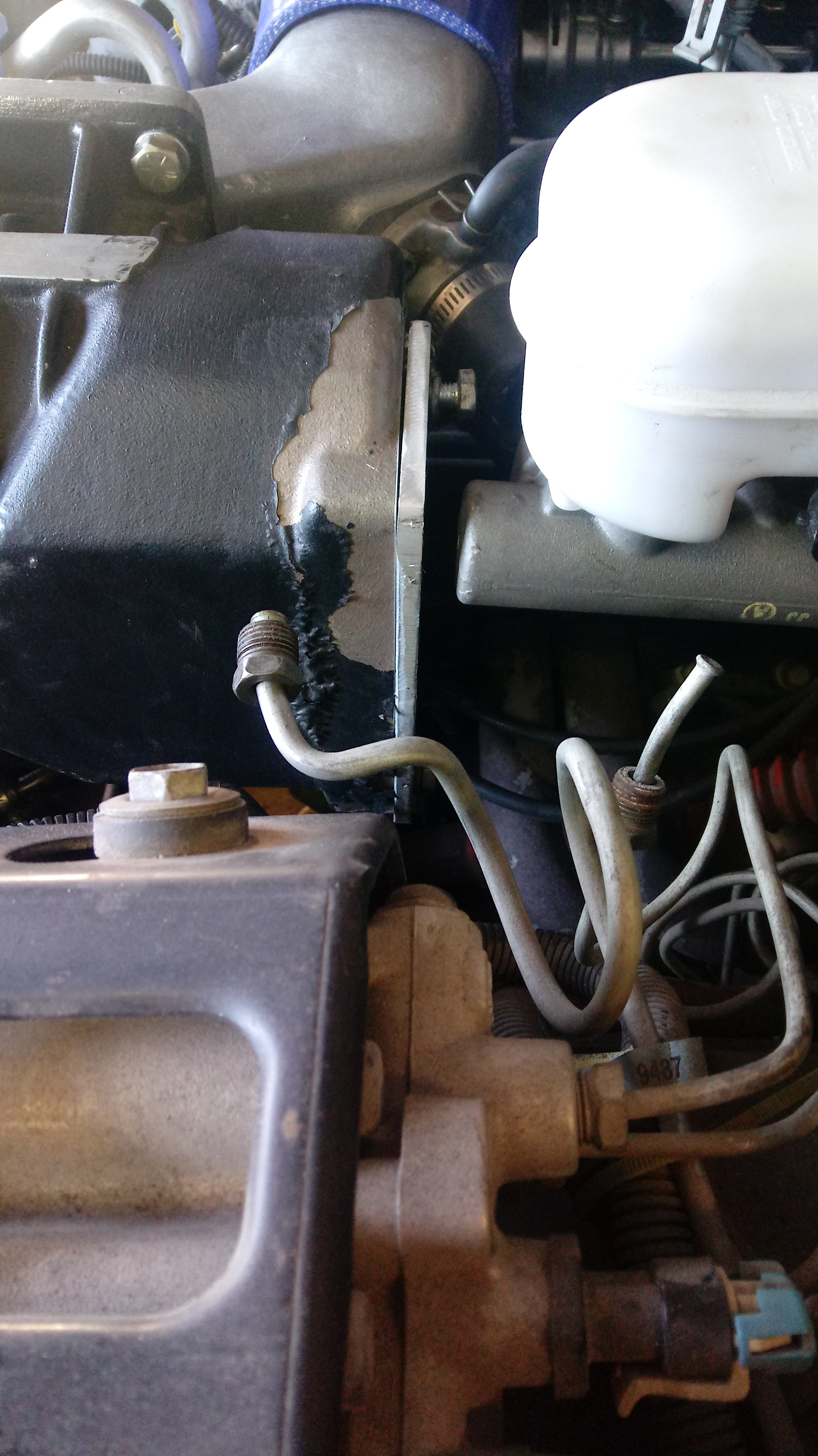

the whipple is in the s10 engine bay.

the blower was hitting the stock brake master so I changed it out for a smaller one but the stock intake tube still hit so I am fabbing up a new intake tube.
