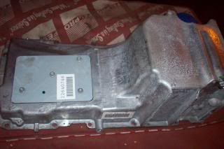

what oil pan is this?
Old Jan 20, 2014 | 08:12 PM
219boone78's Avatar
Joined: Dec 2012
Posts: 37
From: st. john indiana
Default what oil pan is this?
i think this is for a 2wd trailblazer ss but im not for sureName:  001_zpse4ea24b1.jpg
Size:  10.9 KBName:  001_zpsb696ff3a.jpg

Looks like a newer 07+ non dod/vvt truck pan. The dod/vvt has a pressure relief valve right above the oil filter inside the pan. At least those are the only ones that i know of that have that bolt on plate on the front.

I agree with RS/SS 4.8, what else are you wanting to know about it?
Post up the numbers or a pic of the barcode label on the right side of the pan.

well i want to post it for sale but i dont know what to list it as thats all.

It's a truck pan. TBSS pans have a front sump with a hole through the center for the axle shaft on awd models.
