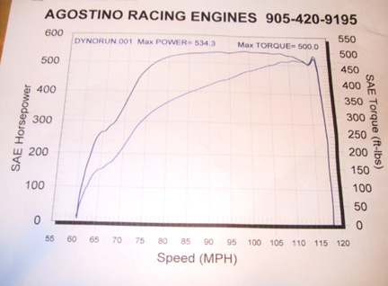

Well after a long wait the truck was finally able to make a full run on the dyno with the
Built 6.0l and procharger combo
This was the first pull of the Day the truck was hot and un tuned this was going to be our baseline run to see where we stood with fueling
Wade from ARE was behind the wheel on the first pull managed to do most of the run before some intake tubing blew apart
a mere 8psi on the dyno

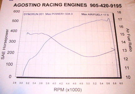

after he let off and shut here down we looked at the atap run to figure out i was out of injector at that point over 100% at like 5500rpm
the truck was still making power so we had a quick discussion on what we were going to do
He had a set of 57lbs injectors around from the Silver Z
we put them in and went for another go
Wade got on it and I watching to the side of the truck Violently jerked forward
it looked like the wheels broke loose on the dyno
The belt slipped bad on the run and netted nothing higher
We all agreed that beating on it anymore would be a waste so we uinstrapped
We made
534.3 rwhp
500 rwtq
without ANY tuning anything
there is still a lot left in tuning this motor and combo for sure
bring on the turbo !!!
Jim
Attached Thumbnails Well the Dyno Numbers are in-interior-lights-2-2.pdf   Well the Dyno Numbers are in-img_0016smaller.jpg

trying to post some dyno sheets
she made some nice torque by by 3800rpms I was at 500rwtq

nice Jim! Time to get that A/F under comtrol

nice Jim! Monster torque already!Time to get that A/F under control
